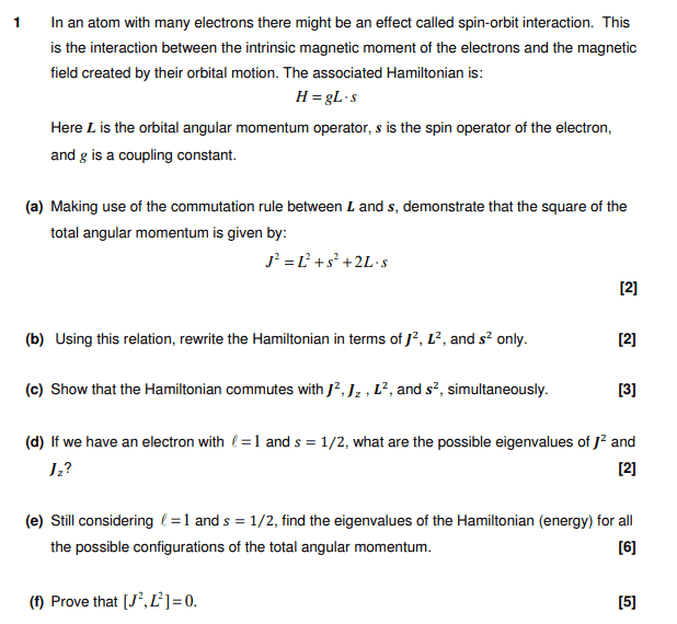

Parts (c) and (f) are the ones I'm having trouble with;
Typeset homework problem 1 on spin-orbit interaction: Hamiltonian H = gL.s, parts (a) to (f) asking to derive J^2 = L^2 + s^2 + 2L.s, rewrite H, show commutation, find eigenvalues.
[/B]
For (c), I assume the problem is meant to involve using the result from part (b), which was H = g(J2 - L2 - S2)/2 .
I was trying just to do it by first showing that H commutes with J2 , and then was going to do the same for L2 and S2, and also I would have just stated that Jz commutes with J2 and therefore also with the Hamiltonian.
But I wasn't entirely sure how to show that this. I tried:
[H, J2] = (g/2) [ J2 - L2 - S2 , J2 ]
=(g/2) ([ J2 , J2] - [L2, J2 ] - [S2 , J2 ])
= (g/2) (0- [L2, J2 ] - [S2 , J2 ])
But I wasn't sure how to show that these last 2 terms are 0. Also I assume this isn't the best method, because it doing it this way you would be answering part (f) in the process. Is there a different method, for only 3 marks?
Any help is appreciated

If I remember correctly a scalar operator commutes with every operator, and a square of an operator is scalar.
And a scalar operator is basically, ##s\cdot I## where ##s## is some scalar and ##I## is the identity operator, and you can prove that the identity operator commutes with any other operator.

Hi. There is no need to rewrite the Hamiltonian, it is easier to leave in the form ##g L \cdot s##. First, note that ##L^2## is a Casimir operator, it commutes with any function of the ##L_i##. They give a hint: what is the commutation relations between the ##L_i## and ##s_j##? Using these two results it is trivial to calculate the commutator or ##L^2## with the Hamiltonian. The other commutators are easy to find using again that ##s^2## commutes with all the ##s_i## and that ##J^2## commutes with all the ##J_i##.
