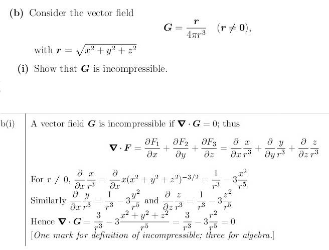

As you can see, the solution is shown just below the question.
Essentially, I don't understand how the x, y and z component of the vector field has been separated because the numerator of the vector field's fraction is: (x^2 + y^2 + z^2)^(1/2)
It seems like they've just taken x^2 out and square rooted it to get 'x', but you can't do that, can you?

That isn't what they have done. The numerator is bold faced ##\bf{r}## and the denominator is ##r##. The first is the vector and the second its magnitude. r = xi + yj + zk.

Do I treat the non-bold r as a constant?
If sub in bold r, I get:
G = [(x^2 + y^2 + z^2)^0.5 ] / 4*pi*r^3

I just noticed in your graphic under (b) they have ##{\bf r} = \sqrt{x^2+y^2+z^2}## That should not have been a bold face r. The bold face r represents the vector and the plain r its magnitude, which is not constant.
