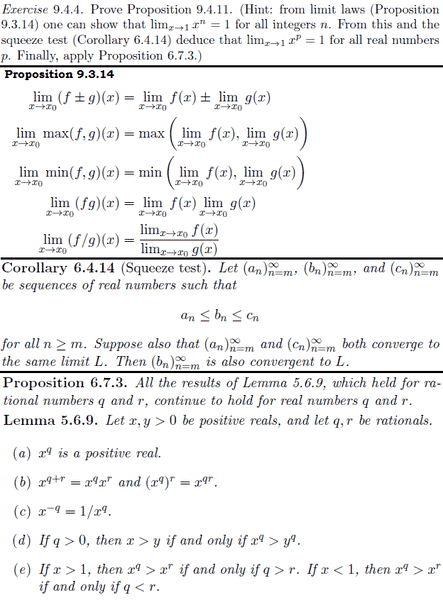

Let ##p\in\Bbb{R}##. Then the function ##f:(0,\infty)\rightarrow \Bbb{R}## defined by ##f(x):=x^p##. Then ##f## is continuous.
I need someone to check what I've done so far and I really need help finishing the last part. I am clueless as to how to show continuity for arbitrary ##x_0\in\Bbb{R}##. I am following the hint given (see image), which asks me to apply proposition 6.7.3., but I don't see how that would complete the proof.
Show: ##\lim_{x\rightarrow 1}x^n=1##[/B]
CASE 1: ##n\in\Bbb{N}##; consider ##f(x)=x##. By 9.3.14., ##\lim \limits_{x\to 1}(ff)(x)=\lim \limits_{x\to 1}f(x)\lim \limits_{x\to 1}f(x)=\lim \limits_{x\rightarrow 1}x\lim \limits_{x\to 1}x=1##.
CASE 2: ##n<0##; ##\lim \limits_{x\to 1}x^n=\lim \limits_{x\to 1}\frac{1}{x^{-n}}##. Since ##-n\in\Bbb{N}##, by 9.3.14., ##\lim \limits_{x\to 1}\frac{1}{x^{-n}}=\frac{\lim \limits_{x\to 1}1}{\lim \limits_{x\to 1}x^{-n}}=1##.
Show: ##\lim \limits_{x\rightarrow 1}x^p=1## for all ##p\in\Bbb{R}##.
Note that ##\forall p\in\Bbb{R},\exists m,n\in\Bbb{Z}## such that ##m<p<n##. By proposition 6.7.3., if ##\vert x\vert<1## and ##m<p<n##, then ##x^n<x^p<x^m##. Thus, by the squeeze test ##\lim \limits_{x\to 1}x^m=1=\lim \limits_{x\to 1}x^n## implies ##\lim \limits_{x\to 1}x^p=1##. On the other hand, If ##\vert x\vert>1##, then, by proposition 6.7.3., ##m<p<n## implies ##x^m<x^p<x^n, \forall x\in\Bbb{R}##. Again by the squeeze test, ##\lim \limits_{x\to 1}x^m=1=\lim \limits_{x\to 1}x^n## implies ##\lim \limits_{x\to 1}x^p=1##.

Your limits are all around ##x=1##, which will not help in proving the proposition for all real ##x##. The hint contains many inequalities involving a real number exponentiated by a rational. That suggests that, if you can prove the claim holds for rational exponents, you can squeeze ##x^p## for irrational ##p## between two sequences of ##x## raised to rational powers.
The first step is to try to prove the claim holds for positive rationals ##p##, ie prove that the function ##x\mapsto x^{m/n}## is continuous for any positive integers ##m,n##. Proposition 9.3.14 and items a, b from Lemma 5.6.9 can help you with this.
The second step is to extend that result to negative rationals, for which item c from Lemma 5.6.9 will be useful.
The third step will be the squeezing, but first see how you go with the first two steps.

For general ##x_0 > 0## we have ##x^p = c (x/x_0)^p,## where ##c = x_0^p.## So, for ##x## near ##x_0## you have ##y = x/x_0## near 1.

@Terrell Actually, given what you've proved in the OP, you can reach the desired result fairly quickly without going through all the steps I suggested above. You just need to do a bit of epsilon-delta work to close the proof.
You have already proved that the function ##x\mapsto x^p## is continuous at ##x=1## for arbitrary ##p\in\mathbb R##.
To prove continuity at ##x_0>0##, given ##\epsilon>0##, we need to find ##\delta>0## such that if ##|x-x_0|<\delta## then ##|x^p-x_0{}^p|<\epsilon##. Given an ##\epsilon## that we want to constrain the distance of ##x^p## from ##x_0{}^p##, find a corresponding ##\epsilon'## to use in the limit you proved in the OP, that constrains the distance of ##(x/x_0)^p## from 1. Use the epsilon-delta properties of that limit to assert the existence of a corresponding ##\delta'## for that limit, that satisfies the ##\epsilon'## requirement. That ##\delta'## constrains the distance of ##(x/x_0)## from 1. So convert it to a ##\delta## that constrains the distance of ##x## from ##x_0## so that the ##\epsilon## requirement is satisfied.
This may sound a bit obscure but believe me there is a hint in there. I'm afraid I can't say more without giving too much away.

I think I am hyper-obsessing over this, but I think I understand the gist of the ##\epsilon-\delta## proof you're suggesting and it goes something like this. Consider
\begin{align}
\vert x^p -x_{0}^p\vert<\epsilon \Longleftrightarrow \vert \frac{x^p}{x_{0}^{p}}-1\vert <\frac{\epsilon}{x_{0}^p} \Longleftrightarrow \vert (\frac{x}{x_0})^p -1\vert< \frac{\epsilon}{x_{0}^p}.
\end{align}
Since as ##x\to x_0## implies that ##\frac{x}{x_0}\to 1## and it has been shown that ##\forall y>0## that ##\lim \limits_{y\to 1}y^p## exists (i.e. ##\lim \limits_{y\to 1}y^p=1##), then, certainly, ##\vert (\frac{x}{x_0})^p -1\vert## will eventually be less than ##\frac{\epsilon}{x_{0}^p}##. Because ##\epsilon## is arbitrary, we could write ##\vert (\frac{x}{x_0})^p -1\vert< \epsilon'## where ##\epsilon'>0##.
It's informal since I was not able to express ##\delta## formally, but I hope I got the idea right. Thanks!
You're on the right track. The ##\frac{\epsilon}{x_0{}^p}##is the ##\epsilon'## I was talking about, that is used in the epsilon role when we use the fact you proved in the OP about the limit near 1.
The next step is to use that limit near 1 to assert the existence of a ##\delta'## such that when ##\left|y-1\right|<\delta'## we have
##\left|y^p-1\right|<\frac{\epsilon}{x_0{}^p}##. Then we substitute ##x/x_0## for ##y## and with some rearrangement we can get the desired ##|x^p-x_0{}^p|<\epsilon##. What remains is to state what the ##\delta## is for this limit. It will be a function of ##\delta'## and ##x_0##.
Note that we are using two epsilon-delta arguments chained together - one involving ##\epsilon'## and ##\delta'## for the limit near 1 that you proved in the OP, and one involving ##\epsilon## and ##\delta## for the limit near ##x_0## that we are trying to prove.
