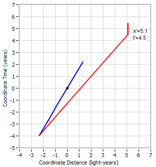

Let's take a look at that previous line (in bold) and the ones before it to provide the context:
morrobay said:
If v= .6c to travel three light years one way , 3/3/5c = 5 years outbound + 5 years inbound from stationary twin reference. Gamma = 1.25 So in relation to above question : Δ t = γ(Δt' + vΔx')
Outbound Δ t = 1.25 [4+(.6)(-2.4)] = 3.2 yr

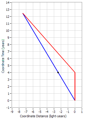

I think I understand what you did here and I see no problem with it. Tell me if these spacetime diagrams depict your scenario and your calculation:
We start with the rest frame of the traveling twin shown in red as he is traveling away from the stationary twin shown in blue. His clock at the moment of turnaround is at 4 years and you want to use the simultaneous event shown as a black dot for the stationary twin. You show this as the Δt' parameter in the bolded equation for the Coordinate Time interval from the start of the trip. You calculated the Δx' parameter by multiplying the velocity, -0.6c, times the Coordinate Time of 4 years to get -2.4 light years. Here is the corresponding spacetime diagram:
Next you want to transform this to the rest frame of the stationary twin which you can do by setting the speed to 0.6c. (This is backwards from the more usual form of the LT where the speed is negative but the sign at the front of the product is also negative so it ends up being positive.) Here is the rest frame of the stationary twin with the black dot showing the value of Δt=3.2 years:
You didn't show the calculation for Δx but if you had it would have gone like this:
Δx = 1.25 [-2.4+(.6)(4)] = 0 light years. This is also correctly depicted on the diagram. I agree with what you have done so far.

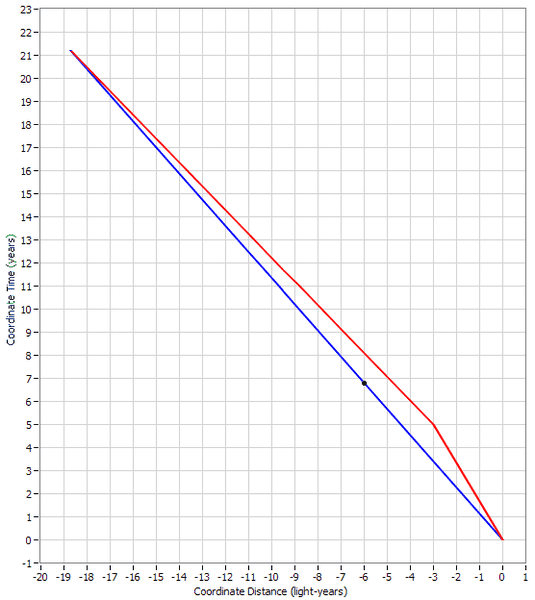

Not the same as turnaround time. If you look more closely at the + and - signs you will see they are not the same. Also note that it is these different signs on values in equation that account for turnaround time of 6.8 years
Now here is where not calculating the spatial interval, I think, has gotten you into trouble. If you had it would have gone like this:
Δx = 1.25 [-2.4+(-0.6)(4)] = 1.25 [-2.4 -2.4] = 1.25 [-4.8] = -6 light years. This should also be zero for a legitimate analysis. Here is the space time diagram that you get when you transform the first diagram to the same speed but opposite direction as the second diagram:

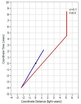

Now if we continue on to your last calculation:
morrobay said:
Inbound Δt = 1.25 [ 4 + (-.6)(2.4) = 3.2yr.
It appears to me that this corresponds to the rest frame of the traveling twin on his way back:
The intervals for the stationary twin that is simultaneous with the traveling twin's turnaround event are Δt' = 4 years and Δx' = 2.4 light years and the corresponding event is shown by the black dot. Transforming to a speed of 0.6c, we get:
This shows the same time interval that you calculated before of 3.2 years. If this accurately portrays what you had in mind, then I agree with this part.
However, the first and third calculations of 3.2 years don't add up to 10 years and they illustrate the famous "time gap" that occurs when the analysis has the traveling twin "jumping" frames.

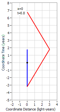

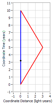

Let's go back to the original frame:
Obviously, I had to know the answer to the question of what the total time is for the stationary twin in order to draw this diagram but let's assume we don't know that and we want to let the Lorentz Transformation process determine it for us. Here's another truncated version of the diagram showing just a little progress for both twins after the turnaround time:
We used this frame to calculate the time from the beginning of the scenario (where the origin is) to the event depicted as the black dot on the stationary twin's worldline that is simultaneous with the turnaround event on the traveling twin's worldline. Then we transformed to the stationary twin's rest frame to determine how much time progressed for him from the beginning to the black dot.
Now we want to do a similar thing but starting with the black dot and going up to the reunion of the twins. So the first thing we want to do is shift the origin up to the black dot. All we have to do is add 2.4 to all the x coordinates and subtract 4 from all the time coordinates. This puts the coordinates of the turnaround event at x'=2.4 and t'=0:
Next we transform all the coordinates to a frame moving at v=0.6 and we get new coordinates for the turnaround event of x'=3 and t'=1.8:
We have to transform to another frame moving at v=0.6 to get the traveling twin's worldline to be vertical. The coordinates of the turnaround event in this frame are x'=5.1 and t'=4.5:
Now we want to move up from the traveling twin's turn around event by 4 years to the reunion event and we end up with coordinates of x'=5.1 and t'=8.5:
Finally we are ready to take the last transform, this time with v=-0.6 and we get new coordinates for the reunion event of x=0 and t=6.8 which is our desired features:
And we can extend the stationary twin's worldline by 6.8 seconds to the reunion event:
