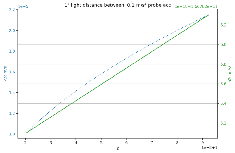

For example, what I do there:
[CODE lang="python" title="Simultaneous proper times in S1, S2 from cm midpoint observer"]
# Used to find intersection of simultaneity line from tc in CM to corresponding t1 in S1
tc11 = lambda t1,k: (C2/A0)*(k*sinh(A0*tc/C)-sinh(A0*t1/C))
tc12 = lambda t1,k: (C2/A0)*(k*cosh(A0*tc/C)-cosh(A0*t1/C))+(0.5*L0)
# Used to find intersection of simultaneity line from tc in CM to corresponding t2 in S2
tc21 = lambda t2,k: (C2/A0)*(k*sinh(A0*tc/C)-sinh(A0*t2/C))
tc22 = lambda t2,k: (C2/A0)*(k*cosh(A0*tc/C)-cosh(A0*t2/C))-(0.5*L0)
t1,k=findroot([tc11,tc12],(tc,1.0))
t2,k=findroot([tc21,tc22],(tc,1.0))
# Coordinates (ct,x) for Earth frame
ct1,x1=ct_x(t1,A0,-0.5*L0)
ctc,xc=ct_x(tc,A0,0.0)
ct2,x2=ct_x(t2,A0,+0.5*L0)
# Proper (=real) distance from CM to...
lc1=sqrt(power(x1-xc,2)-power(ct1-ctc,2))
lc2=sqrt(power(x2-xc,2)-power(ct2-ctc,2))
[/CODE]

And, last but not least, I attach a simulation of the situation of the space probe, @1 week after departure, traveling at 0.1g, if both probes are separated by a 1" light distance.
Thanks a lot for you patience.
