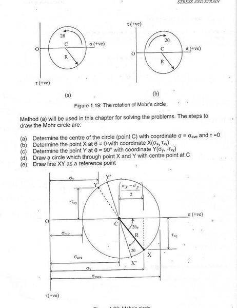

I doubt that is the following notes (in the first picture), correct or not?
Because i couldn't find any proof in the other book...
Can I say that consider σ positive to right and τ positive downward, orientation (θ) clockwise as positve , rather than counterclockwise is positive ?
