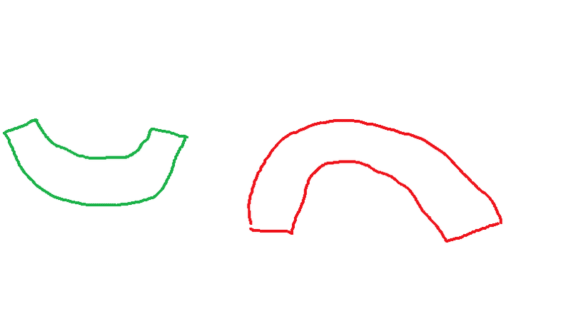

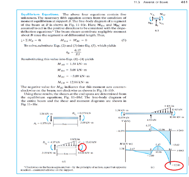

In this question , we can see that in the second picture , the 12.86kNm is in clockwise direction at the right of span BC .
In meachnic of materials , i learned that when the beam curve upwards ( U shape) , then it has positive bending moment ... So , I agree that the 1.54kNm clockwise rotation on the left of span AB has POSITIVE moment ... But , i don't agee that the 12.86kNm is in clockwise direction at the right of span BC has positive value ( it's -12.86kNm on the left , so POSITIVE 12.86kNm is added to bring the moment to 0 at C) ... I think the -12.86kNm on the right of span BC will lead to negative moment

Yes, the ends are both fixed and at the left end the deflected curve is upwards, or positive moment by convention, and at the right end the deflected curve is downward so the moment is negative. So the moment is -12.86 at the right end.
Note when drawing the moment diagram, fixed end moments and applied couples , when acting clockwise , add to the moment diagram as a positive value. That is why at C the cw moment of 12.86 is added as a plus to bring the moment to 0 a hair to the right of C. But by convention, the fixed end moment at C is indeed a negative 12.86. It can get confusing, for sure.

By convention, clockwise moments are negative when acting on a section to the left of it, and clockwise moments are positive when acting on a section to the right of it. Similarly, counterclockwise moments are positive when acting on a section to the left of it, and counterclockwise moments are negative when acting on a section to the right of it. so in your case, the 12.86 moment acts clockwise on a section to the left of it, and is thus negative. Rather confusing I know, so it is always a good idea to roughly sketch in the deflected shape of the beam, and if it faces upward it is a positive moment in that region, and when it faces downward, it is a negative moment in that region.
Now when drawing your moment diagram from left to right, the fixed end moments point upward when clockwise, and downward when counterclockwise.

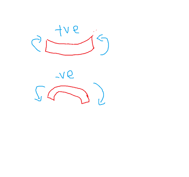

As we draw the BENDING MOMENT DIAGRAM from left to right , for FIXED END moment , when it's in clockwise direction , it will bend the beam upwards , so , it's positive ?
Conversely , if the FIXED END moment is in anticlockwise direction , it will bend the beam downwards , so , it's negative?

FEM of 12.86 upward because it is clockwise.
it is positive 12.86kNm because the clockwise moment will make the left portion of he beam to curve upwards , while the right end in fixed ? Can i explain in this way ??
No you cannot. The 12,86 moment is NEGATIVE if you read my prior posts. The section immediately to the left of it curves downward.

in the previous post , you said my sign convention curve u shape upwards is positive is correct (refer to photo) ? And your current comment stated that when the beam curve 'n' shape is positive ?
Can you clarify it ?
PhanthomJay said:
Upwards U shape is pos mom and upside downU shape is neg mom
what are you saying ?

What you mean is like this ? The red part has positive sign convention ?
But , i also remembered you said that my sign convention positive is correct when the beam bent upwrads ( green part) in post 2 ?
So , which beam has positive sign convention ? bent upwards or bend downwards ?

As you noted in your very first post attachment 621.png, bent upwards is positive and bent downwards is negative. I thought that was already established. You will also note in that attachment that clockwise moments acting on a section to the right of it, and counterclockwise moments acting on a section to the left of it, are positive moments. You also showed this correctly. The sketch is 100 percent correct.
You can confirm this by looking at figure 11-10 (b). Notice at the extreme left , the beam bends upwards initially, and the moment M_AB is clockwise acting on he section to the right of it, thus, this agrees fully that the moment M_AB is positive. And notice at the extreme right, the beam bends downward initially, and the moment M_CB is clockwise acting on the section to the left of it, thus, this agrees fully that the moment M_CB is negative.
Is this clear now?

Can you explain how the negative moment -12.86kNm is brought to 0 at the extreme right end ?
fonseh said:
No , i show that in that attachment that clockwise moments acting on a section to the right of it, and counterclockwise moments acting on a section to the left of it, are NEGATIVE moments , (curve downwards)
What we have here is a failure to communicate. The attachment shows that clockwise moments acting on a section to the LEFT of that moment is NEGATIVE. Please look at the lower sketch in your attachment, the one showing the upside down U deflected shape of the beam. We know that moments are negative in this section. And the clockwise moment at the far right acts on a section to its left. I guess you mean that the clockwise moment lies to the right of the section. Whatever is the way to describe it in words, the sketch is correct.
Well when drawing moment diagrams, first off, the fixed end (concentrated couple) moments (FEM) at either end don't in theory go to zero, they are what they are, that is, in this example, at the right end, the FEM is negative 12.86 kN-m. In actuality, concentrated moments , just like concentrated point loads, don't exist, because they are applied over zero width, which leads to the infinities that nature despises. But anyway, let's assume the moments start and end at 0. As you draw the moment diagram (after first drawing the shear diagram) from left to right, when you get to the right end , the moment in the beam is -12.86, then in order to close it to 0, you add in the clockwise FEM of 12.86 to get -12.86 + 12.86 = 0. Notice here that when drawing moment diagrams , clockwise moments are always considered positive, and this is unrelated to our previous discussion on moment signage .

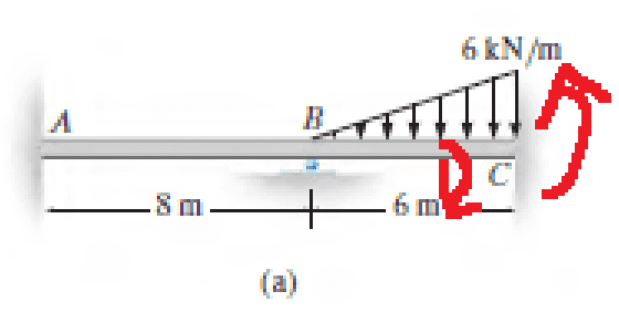

Can you explain this one ? I noticed that the clockwise 12.86kNm clockwise moment acting to the right of span ...
You are posting faster than I can respond, so we're getting messed up here.
Yep, the clockwise moment acts to the right of the span, therefore, the span is to the left of the moment, same thing, moment is negative, sir.

Do you mean that the moment clockwise 12.86kNm is acting to the left of span ? So , to become 0 , anticlockwise moment 12.86kNm is required to bring it to 0 ?

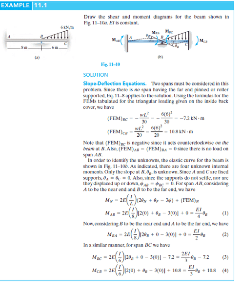

sorry , why for clockwise fixed end moment is positive ?

The issue may be this:
There are 2 different sign conventions,
-- one for external moments, and
-- one for internal moments.
Let's look at the internal moments first. Internal moments exist within the beam itself and are caused by the applied loadings.. The sign of those moments have been I hope well established already in the prior posts, that is to say, internal moments that cause the beam to deflect concave upward (like a smiley face) are positive, while internal moments that cause the beam to deflect concave downward (upside down U) are negative. The cw or ccw direction of these moments are as established in your famous third attachment on post 1. These signs by the way...plus or minus...will come directly from your moment diagram without having to look at the curved shape of the deflected beam...provided you draw the moment diagram correctly, however.
So speaking of the moment diagram , now let's look at the external moments. External moments are either directly applied moments (couples) or fixed end support reaction moments (FEM). Both types of these external moments have the convention of positive if they are clockwise, or negative if they are counterclockwise. This is unlike the internal moments where clockwise moments can be plus or minus depending on which side of the beam section you are looking at. But again, clockwise external moments are always positive.
So in conclusion, looking your original problem, the internal moment in the beam at the right end is clockwise on a left hand section and thus a negative 12.86, and since the FEM is an external clockwise moment, it is a plus 12.86, which closes your moment diagram to 0.

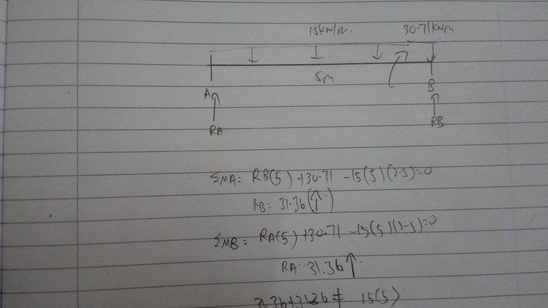

i have an example below .The beam has UDL load of 15kN/m , conc couple of 30.71kNm clockwise . for moment about A and moment about B , i let the concentrated couple clockwise couple 30.71KNm as positive , but i didnt get the ans . So , for the sign convention of the clockwise concentrated couple is positive only applicable in drawing bending moment diagram only ? But , not when calculating the forces using equilibrium equation ?
Here's actually a part of working in my book . So , i just take the certain part only . Not the whole question .
When i made another attempt , i gt moment about A = RB(5) -30.71 - 15(5)(2.5) = 0 , RB = 43.5kN upwards , i gt the ans

The positive sign convention of the clockwise concentrated couple is applicable in drawing bending moment diagram. When calculating the forces using equilibrium equation, you can choose clockwise or counterclockwise as plus or minus, but be consistent. I always recommend using clockwise moments as positive when determining force reactions.
Sure, your first attempt messed up the signage. Use clockwise moments as plus, whether from a 'force times distance moment' or applied moment or couple, and you'll get the right answer. Your equation summing moments about B is good! But when summing moments about A, it should be RB(-5) + 30.71 + 15(5)(2.5) = 0. RB = 43.64 up.

is my working of RB(5) -30.71 - 15(5)(2.5) = 0 incorrect ?
For moment about A , i have M(A) -RB(5) +30.71 + 15(5)(2.5) = 0 , thus , moment about A = RB(5) -30.71 - 15(5)(2.5) = 0 , RB = 43.64 up
I did in this way because for the left end of span , clockwise moment is positive ( cause the beam to bend upwards) , similarly , when finding moment about B , I assume anticlockwise as positive .(because anticlockwise moment causing the right span to bend upwards) Moment = M(B) -RA(5) + 30.71-15(5)(2.5) = 0 , 31.36 up
Or should I be consistent , keeping clockwise moment as positive and anticlockwise as negative or vice versa?
