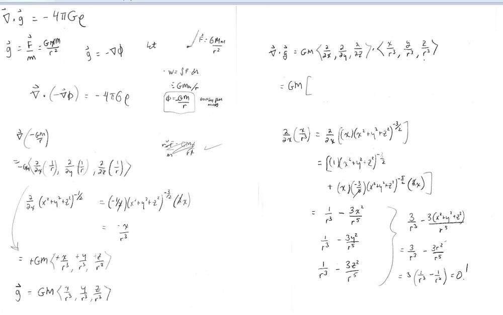

I'm having a math problem with Gauss's law for gravity for a point mass M. Or is my interpretation of the law wrong?
i have little experience with the differential form of Gauss's Law, and I've tried three times now to arrive at it for a point mass M (spherically symmetric classical gravitational field) but instead of getting an answer proportional to the mass density I keep getting zero. Is the divergence supposed to be zero? Intuitively I would say no since all the field lines are pointing away from the origin, but then maybe the fact that they get smaller as r increases makes a difference. Scanned and uploaded my work since LaTeX can be a bit tedious.
  • Handwritten derivation of the divergence of the gravitational field g = GM r-hat / r^2 for a point mass, with the Cartesian components differentiated to show the divergence reducing to zero away from the origin.

why don't you show theGauss's law form that you used? No one can diagnose what the problem here is based on your vague description.

Yes, interestingly ##\nabla \cdot \frac{\hat r}{r^2} = 0##.
What are you missing?
I used [itex]\nabla \cdot (\nabla \phi) = -4 \pi G \rho[/itex] with [itex]\phi = -GM/r[/itex] in three dimensional Cartesian coordinates. Okay, I wasn't sure if the answer should be zero or [itex]-4 \pi G \rho[/itex] with [itex]\rho = M/((4/3) \pi r^3)[/itex]. Thanks!

Is it ##0## everywhere?
Yes, it appears to be zero everywhere except at the origin, where [itex]\phi[/itex] is undefined.
I don't have an intuitive sense of what this result means. Using a different formula for the force of gravity (pretending it's proportional to [itex]1/r^3[/itex] instead of [itex]1/r^2[/itex] for example) produces a non-zero divergence, even though in both cases the mass of the object creating the field is non-zero.

Mathematically, the divergence theorem does not apply in this case because of the function at ##r=0##.
One solution is to consider a small but finite mass at the origin. In which case, all the divergence is in that small region, and zero outside it, and thew divergence theorem holds.
The other option is to define the divergence of the inverse square function as a three-dimensional Dirac Delta function. In this case, you use Gauss's law (the value of surface integral) and insist that the volume integral must have the same value, hence the divergence must be a Delta function.

I was actually more curious about the fact that [itex]\nabla ^2 \phi =0[/itex] outside of the sphere even though the gravitational field itself is non-zero. Rather like how the Schwarzschild metric represents a non-zero gravitational field and is itself a "vacuum solution" to Einstein's equation. In fact what prompted this subject for me was the beginning of chapter 8 of Schutz's "A First Course in General Relativity" in which he arrives at Einstein's field equation using the Gauss law as a kind of analogy. If I remember correctly Einstein himself does too in his original paper.

Divergence identifies sources of the field. In regions where there is no matter (or electric charges in EM field theory), you have Laplace's equation: $$\nabla^2 \phi = 0$$.
