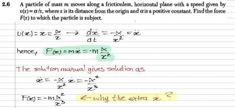

Handwritten solution to a classical mechanics problem: velocity v(x) = α/x, derivation of acceleration, then F(x) = -mα²/x³ with a highlighted question asking why the extra velocity term appears.
Not sure how the extra velocity quantity appears after deriving both side of the velocity function to get acceleration. Please help.
You're given v as a function of x, not as a function of t. Therefore you have to use the chain rule: $$a = \frac{dv}{dt} = \frac{dv}{dx} \frac{dx}{dt}$$
