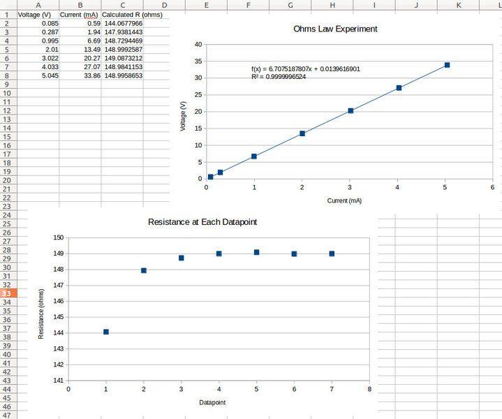

Results are in! The meter the school provides is a Fluke 175 True RMS Meter. The experiment was done with 6 100-ohm resistors, hooked up to give an an equivalent resistance of 149 ohms, this ensured that each used only a fraction of power, and eliminated the heating variable. Voltage was measured across the ends of the resistor chain (instead of relying on the round number in the computer).
I've attached a picture of the data, along with graphs generated, for all interested to see. The linear fit is excellent, supporting ohms law. The effect of resistance approaching the effective resistance as a limit is ... well, see for yourself. Thoughts?
Edit: note that the scale of the graph of R examines a small portion and is exagerated (ie. about 144-149 ohms), instead of just 0-150 ohms. Thus, the trend is almost gone, but is still clearly present.
Your datapoint 1 sure points out the rule "Don't count on that last digit!"
The readings of 0.085V and 0.59mA, when "corrected" in their last digit to 0.086V and 0.58mA yield 148.28 Ohm. In line with the other calculated resistances. Keep this in mind during your journey through Engineering.
It's not limited to just Electrical stuff, ALL measurements have this problem. With mechanical measurement, or any analog measurement for that matter, you get a similar effect with different people doing the reading. Perverse, isn't it?
It appears the meter(s) have opposite calibration issues, although minor. In this case on the low ranges the voltage reading is low and the current reading is high; the combination leading to a lower calculated resistance value. If they are separate meters it would be interesting to see what the low-value readings are if the meters are swapped.

  • #39
It appears the meter(s) have opposite calibration issues, although minor..
The first datapoint may very well be iffy, good point. Is it normal for meters to be oppositely calibrated ... that is, reading low on the voltage, and high on the current? I know the effect we're looking at must be generated by the meter, and it seems tied in with the amount of current generated, since the effect was quite pronounced in the first experiment (current on the order of 0.1 milliamps), and almost gone in the second (order of 10 milliamps)... this makes me suspect that something is eating up current and giving us this effect. But how is the meter doing this? It couldn't be the shunt resistor, could it? Guess I might never know lol. Anyway, narrowing the effect down to the instrument is a great start.

I take it then that both the voltage and current wer taken with the same meter. It is very common for a meter to have a slightly different reading for the same input when on different ranges. The two main causes are
  1. Range changing is done by selecting different resistors within the meter and resistors have a tolerance
  2. The zero adjust may be off a little bit, which effectively adds or subtracts a constant from each reading. For readings near zero, this leads to a large relative error.
It looks like this particular meter has both. Not at all unusual, they aren't perfect.

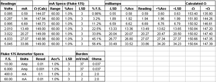

Extending on the rule Tom quoted, "Don't count on that last digit!", I've calculated your current measurements against Fluke 175 meter specifications.
  • Calculated resistance variation is within specified current meter accuracy.
  • I've used measured voltages in resistance calculations as though they are precisely dead-on, but in actuality they too have their own +/- percentage and LSD accuracy limitations, and would have to be worked out to get a more precise idea of the error budget.
  • The first data point of 0.59 mA is only about 1% of 60 mA full scale. If this were an analog meter movement the pointer would have barely moved from zero.
  • Take note how much more the LSD matters at lower values.
  • 0.59 mA +/- 1% basic accuracy is between 0.584 and 0.596 mA (rounded to a resolution of 0.58 and 0.60 above), but it's the least significant digit spec of '3' added to and subtracted from them that makes a bigger difference (0.55 to 0.63 mA). Calculated resistance at 0.085 V are from 135.8 ohms to 153.4 ohms over this current range. The 147Ω test resistor value falls in between them.

  • #45
You are an excellent resource, thanks for running those calculations! The fact that errors grow larger as we near the beginning of the range of the 60 mA scale is particularly interesting. I suppose my last question is, how is the error curve generated? That we may never know. It seems curious that it resembles a function in the family of A - e-x. At any rate, I'm completely satisfied that we are seeing an error introduced by the meter. Thanks to all for your great input!
