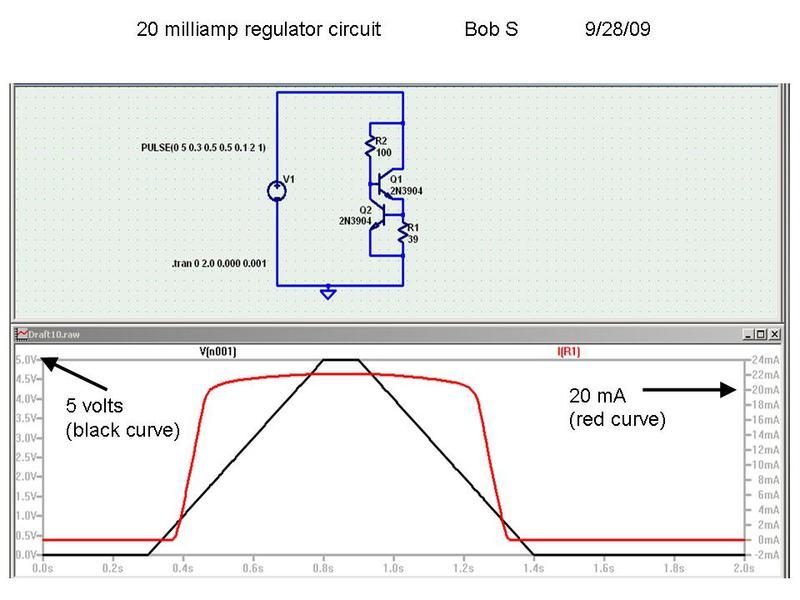

Here (in thumbnail) is the cheapest low-voltage current regulator (limiter) I know. This one regulates current at about 20 milliamps. For applied voltages above 5 V, increase the value of R2.
Bob S
How about a single JFET variation, which eliminates needed BJT matching and possible thermal runaway? Example circuit: http://www.allaboutcircuits.com/vol_6/chpt_5/15.html"

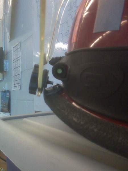

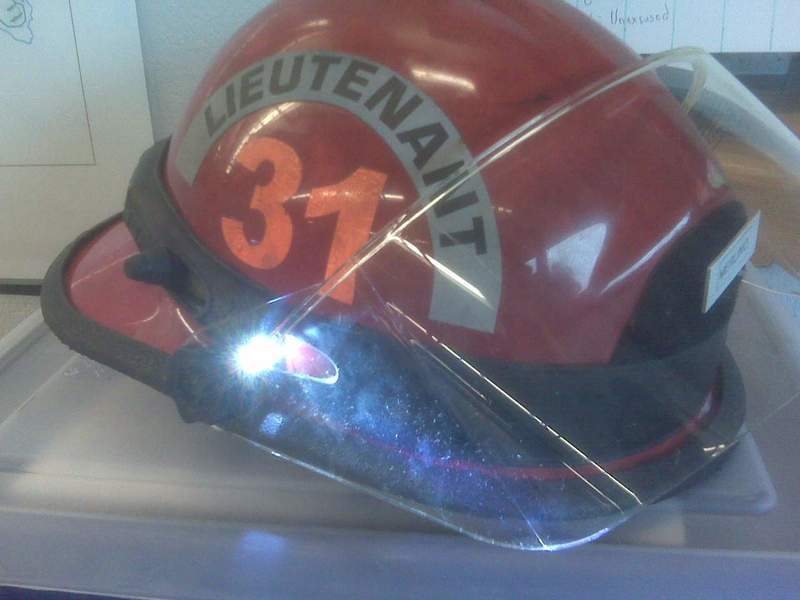

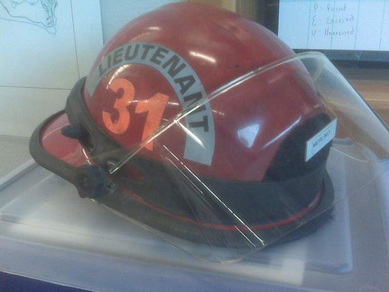

There are several manufactures that make lighting for fire fighters helmets however they all are either seriously expensive (200-400 dollars) OR have some major down falls. When we are working in a non hazardous environment our face shields are up, when we are working a fire or cutting up a car for a rescue our face shields (plastic visor in the pics) are down. The biggest down fall I have found with most inexpensive products are they are bulky (heavy) and either have to mount on top of the helmet brim or under the helmet brim. If they are on top then when you shield is up the light is very diffused and doesn't work well. If they mount underneath then when your shield is down the dirt, dust and scratches on the visor lenses lights up and you can't see past your own helmet. The ones that mount on the front of the helmet don't really work for us either as we have velcro identifiers that we use on the front and the clearances when the shields flips down are very tight.
If you look in the pics I used a commercially available helmet strap and modified two streamlight nano flashlights (1/2 diameter) filling the inside with epoxy (sealing against stray static charges) and hard wiring, to a bigger battery pack mounted underneath the strap and a sealed switch (unsealed switches can create a big spark hazard in an explosive atmosphere). This gives me one light on each side of the helmet and the way the lense sits it gives good light whether the shield is up or down.
My biggest problem is soldering to the little tiny contacts inside the nano's. I am trying to come up with a drop in design or replacement back for them however, sourcing my own brighter LEDs and having custom reflectors/cases may be more reliable and easier to solder. As one of my lights has already stopped working... I think I got the LED too hot when I soldered it and am not sure how to do it in a reliable fashion every time when soldering inside a very small flashlight case.
Normally, LEDs are not too easily damaged by heat and wouldn't need any special precautions (heat sinks/clamps on legs) while soldering them on a PCB, for example, unless one doing the soldering is really slow. I have no idea about high power / extra bright LEDs however.
If heat really is a problem, you could try to wrap thick copper wire (assuming there's no space for clamping) above the joint to help transfer heat away from the LED itself. It won't do miracles, though, so getting the job done right is still essential.
I myself have long periods of time when I'm not soldering anything, so when I'm going to do some "tricky" soldering (for example, in confined spaces) I first do an easy "practice run" (solder a couple DIPs etc) on something standard to get the feeling back how the solder & iron I'm using behaves so that I get consistent results.
When it comes to confined spaces, nothing beats planning how to actually perform the soldering so that it goes smoothly. Doing this with a cold iron in hand and just getting the moves right first helps here. That is, if there's no way of opening up the case more for soldering - usually easier. Good pre-tinning helps too. There might be some utilities which help, but can't think of anything particular here (I rarely have to solder in confined spaces).
Also, I'm not sure what your experience level with soldering is, so this might be a good time to suggest to search google about "soldering tips" - bound to give multiple links to check that you're actually doing the soldering right.
Just make sure you're not doing cold solders, as they're bound to fail fast with the slightest vibration.
All this you may or may not have known already - just wanted to give some basic tips to at least get started and maybe have some ideas where to go from here.
