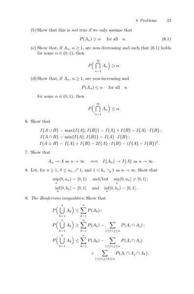

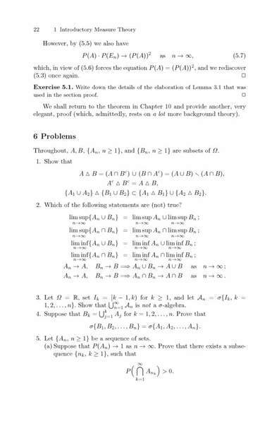

Hi all,
I'm trying to solve the 5th question , it's from Allan Gut's probability : a gradute course .I attached the relevant pages.
For the part (a) I think we don't need to construct the sequence itself, but prove it exists somehow.
For the part (b) we need to find an example.For the parts (b) and (c) , I really don't have an idea. Can anyone help please? Thanx.
  • Scanned textbook page 22 showing the end of section 1 and the start of section 6 Problems, with numbered exercises on sets, limits of events and sigma-algebras.
  • Textbook page 23, section 6 Problems, showing parts (b) to (d) of a probability exercise with inequalities P(A_n) >= alpha and limits of unions and intersections of events A_n.
I'll give you a hint for part (a):
Let {En} be a sequence of sets. For each n, let Cn be the compliment of En.
Suppose that P(C1) = a, P(C2) = a/2, P(C3) = a/4, etc. In other words, P(Cn) = a/2(n-1).
What can we say then about P([tex]\bigcup[/tex] Cn)?
Remember that 1/2n is a geometric series. Tell me, what the sum from 0 to infinity of 1/2n? What about a/2n?Also, if we know P([tex]\bigcup[/tex] Cn), then don't we know P([tex]\bigcap[/tex] En)?
Now, try to assemble these facts together!
Thank you very much for this construction :)) What about part c? How can we show such a thing?
Regards, h.
