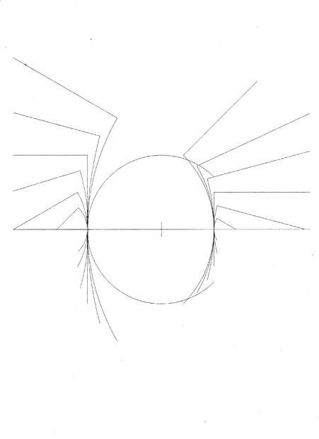

I really appreciate the fact that three of you have replied to me in this physics forum over the past week and given me your critical thoughts on a new lens model I wanted to show to all. One more important point of Huygens is useful, I think, to show now, for further clarification.
Here's a copy of his diagram of the aplanatic point of perfect focus within the sphere (without the construction lines). It is from his "Treatise on Light". He was writing about his re-trace of the conics sequence and ovals of Descartes. He says: "But it is worthy of remark, that in one case this oval becomes a perfect circle, namely when the ratio of AD to DB is the same as the ratio of the refractions, here as 3 to 2, as I observed a long time ago."
So, here's another refractive ratio, as seen on the horizontal axis line ratio Huygens found. He used 1.5 for his glass index models. In the above diagram, the line lengths ratio is the square root of 2, the same value as the other ratios of this model.

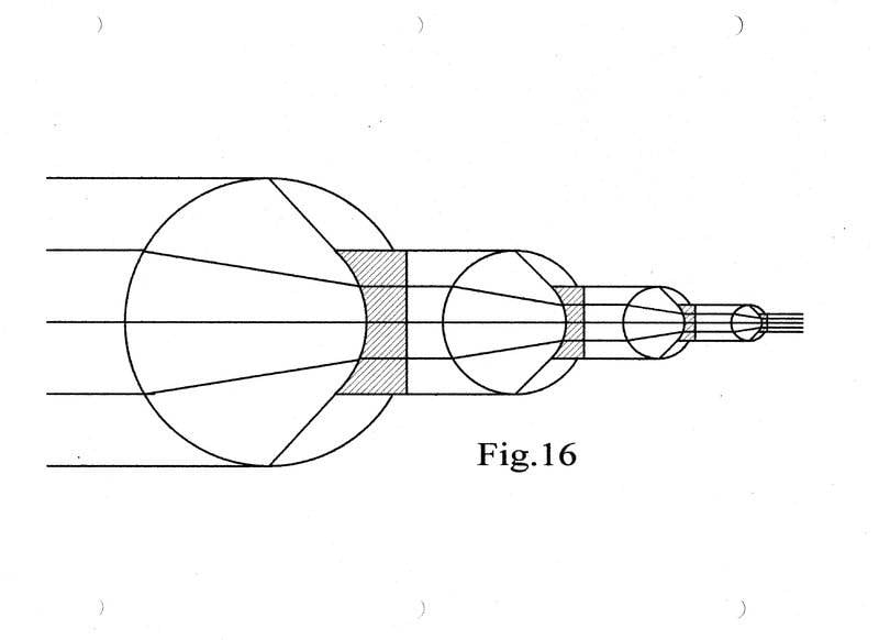

This goes with the earlier sequences shown. Might help. Marginal rays of various, incoming waves and their refracted chords inside a sphere are shown. Also, a source point right at the edge of the first surface, and the aplanatic ray with its extension to horizontal axis, these two angles at the limit points of this model. Bisectors to the refracted chords are shown, and you can see the extent of the second radius needed for each wave at its marginal point.
Drakkith said:
If that is what the math says then I agree with it. However, note that we really don't have a singlet anymore. That typically implies a single lens inside a single medium such that the refractive index on both sides is the same. You've essentially made a cemented doublet.
Yes, cemented doublets, thanks, though I think I could argue the point for a singlet too a bit further.

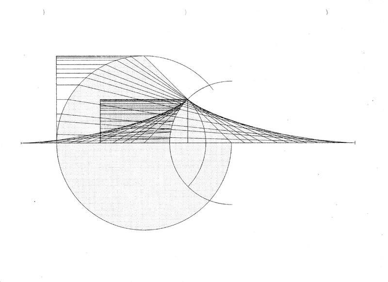

A diagram may help more, but it's a bit messy, sorry. Planar wave again incoming and its refraction pattern of SA shown, the caustic, believe it's called. Also shown is the normal, second surface output flipped around, so its output is now the input. You can see that its refraction pattern is the exact mirror image of the first surface. Its refractive ratio is the inverse of the other. One pattern is a real image, the other a virtual image. This model matches the caustics of all the waves like this. At that point where the rays begin to cross each other, the bisector point of the marginal, refracted ray the sphere. That bisector length that Huygens found.
The model lens is afocal, no internal focus. Of course, it can project or receive from either direction. It is different from thin lenses in many ways, for sure.
Here's my favorite picture for relief. 180 degrees diverging, both Huygens' points shown, maximum extension of radius2. No coincidence that it looks like a "Dutch-cut" haircut too? Huygens is the Dutchman.

I'd say do a full raytrace before trying to consider what the system would be good for. SA might be fully corrected for, but what about other aberrations?
Agreed. Is there existing trace software that can get values for all the positions I've plotted? I used a trigonometric trace and AutoSketch.
What other aberrations? Chromatic? Not sure of that. Have only traced using one index number so far. Might be a big problem for color images, surely. I can think of another lens it absolutely would not be used for. Eyeglasses.
There are dedicated ray tracing software that will plot all your aberrations, but don't I have a link to one right now. A quick google search should turn up some results.
Edit: You might try Optical Ray Tracer. I haven't used it before, but it's a free program that might be what you need. You can find it here: https://arachnoid.com/OpticalRayTracer/

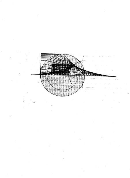

  • Haha
Here's a 30 degree incoming wave. A very strange optical system indeed. Hope you may like this plot. Reminds me of the old SF movie, The Day the Earth Stood Still. Do you know that one?

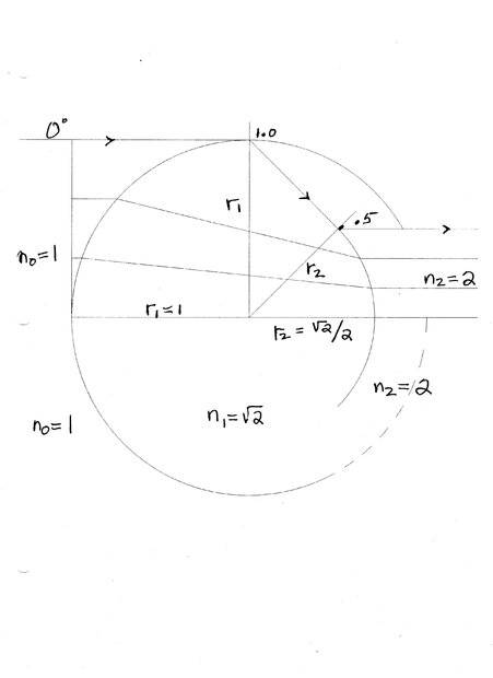

I wanted this post just to show a lens model family with constant magnifications and zero SA. A singlet in principle, a doublet in most all applications. To show the various wave and ray refractions, and to show the historical math connections to Huygens.
I think giving magnification values that I've calculated, and also showing optical path lengths, will further help to convince everyone that these theoretical lenses are really possible. I'll post that diagram and chart of values tomorrow. Thks for seeing this project along.
Are the centers of curvature of each surface located at the same place? I was trying to do a paraxial raytrace, but I don't know how far apart the surfaces are.
difalcojr said:
No idea. Don't know the term at all.
Probably worth looking at.
For the single lens, yes. Monocentric.
Axial distance between surfaces is radius1 plus radius2.
For n0=1, and n2=square root of 2, and radius1=1, radius 2 is then (square root of 2)/2. So, adding radii., you get (1 + .7071...). The answer is 1.7071... for the thickness.
Hmmm. Using this ynu ray trace calculator, I'm not getting what you're getting. My initially parallel ray diverges after exiting the 2nd surface. Not sure if a paraxial ray trace is inappropriate here, or if I'm doing something wrong.
