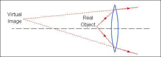

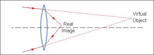

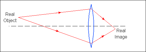

For the common situation where the object and image are real (do and di both positive), the magnification is negative indicating an inverted image with respect to the object.
If the medium surrounding the lens has a refractive index other than 1, then replace the term
(nlens - 1)
with(nlens/nmedium - 1)
in the thin lens equation.Real or virtual?These figures illustrate the three most common situations where the object and image are real or virtual.
Note: a physical object is always real. Virtual objects can occur in multi-lens systems, when the object for one lens results from the image of a previous lens.
The situation where both object and image are virtual is rare, at least in physics homework exercises. This is possible only for a negative (i.e. diverging) lens.Refractive index for common materials:
