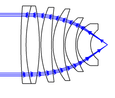

The aplanatic spheres is widely used in the optical design, look at microscopes or condesor systems, for example.

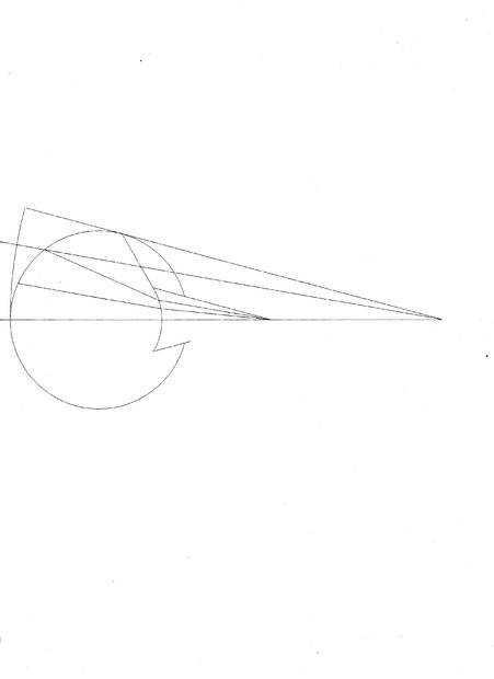

Ray trace diagram of a multi-element lens system, with blue rays entering from the left as parallel beams at two heights and converging to a focus on the right.
Great diagram. Thank you. Hope my attached diagram will help now too.

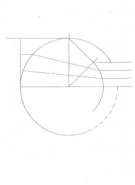

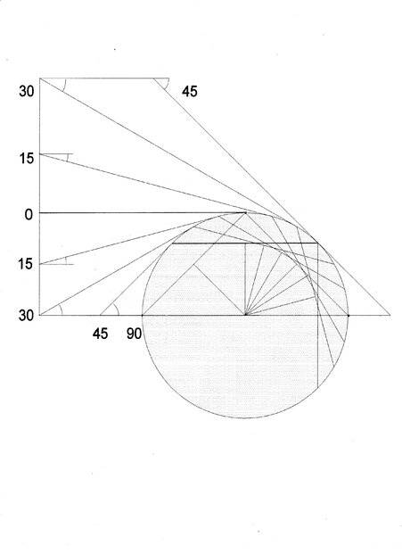

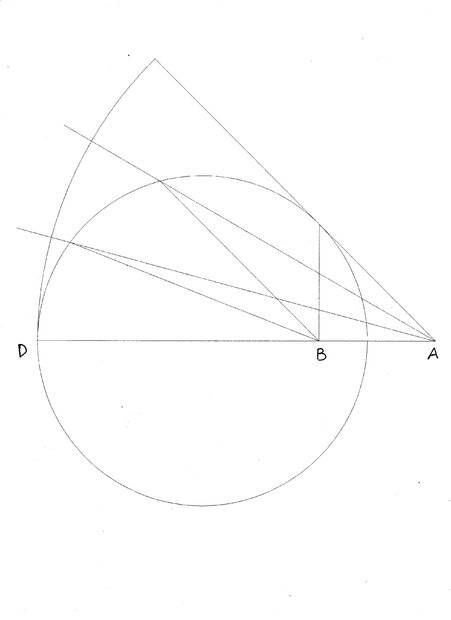

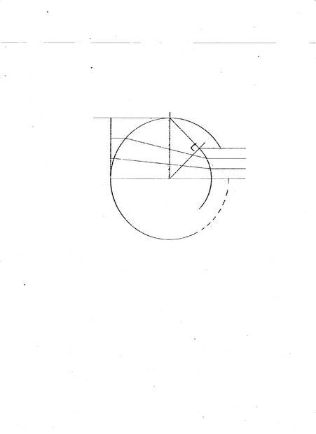

So, in addition to finding the position of the aplanatic point in a sphere, Huygens found the perpendicular distance to the marginal, refracted ray in the sphere. Which is the bisector, and he saw this was the point where the rays first started to cross each other. The lengths are equal and radius2 here.
For the diagram, n0 equals 1, n1 equals the square root of 2, r1 equals 1, and the second incident angle was set equal to the first for the marginal ray, set at 90 degrees.
Here's how to get to my initial sine relations: use the law of refraction with its angles for the first surface, and a sine law equation again for the enclosed triangle. Substitute values and solve for r2. See what you think.
  • Hand-drawn geometric construction of a circle with a horizontal diameter, a vertical line, several straight rays entering from the left and a right-angle mark on a chord inside the circle.
  • Geometric construction of a circle with a vertical radius, a diagonal line from the centre, and several horizontal parallel rays entering from the right, one ray refracting inside the circle.
What is n3 would be? According to picture ray is refracting to the media with n3, and n3>n2.
difalcojr said:
Then,
n1/n0 equals r1/r2 and n0/n1 equals n1/n2 .
Assuming n0 = 1, n1 = 1.4, and n2 = 1:
n0/n1 = 0.666...
n1/n2 = 1.4
How does n0/n1 = n1/n2?
No, not n3. You mean n2, for the three indices that are needed, I am using n0, n1, and n2 only. But, to answer your question, what would n2 be? To get exactly zero SA, it would equal n1 squared, divided by n0. Value of 2 in this example. Look at the second relation again in the first posting to see the sine relation again. This is the easiest example to show, a planar wave. Also, for the indices shown, it is a 2:1 reduction in size.

Oh, you are absolutely right. I have confused it. My apologies. I should have said. Just plug the values into the initial equations given, and solve for radius2 and index2.
Instead, I just added an alternate method I had used myself, initially, using the law of refraction, to get to those initial relations in the first post. The law of refraction, with the sines of the incident and transmitted angles I had not mentioned at all! My bad on that one, sorry. In that method for solution, the sines term drop out of the equations. This model is independent of angle.
Okay. For n0 = 1, n1 = 1.4, and r1 = 1, I get r2 = 0.7143 and n2 = 1.96.
Any idea how many materials have an optical refractive index close to 2?
Yes, that's the ticket! Correct and thank you. The diagram had used the square root of 2 for calculating and plotting ease.

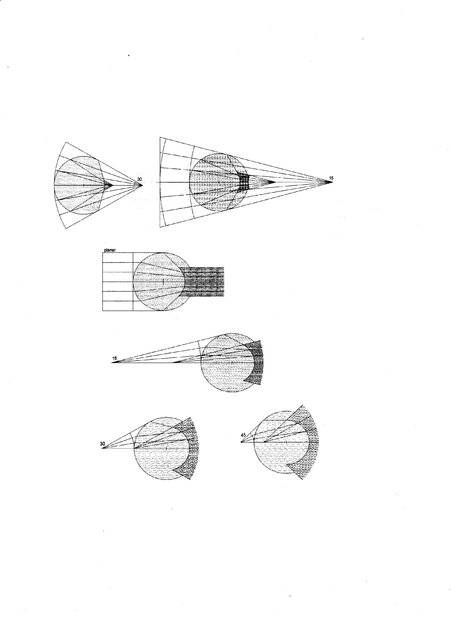

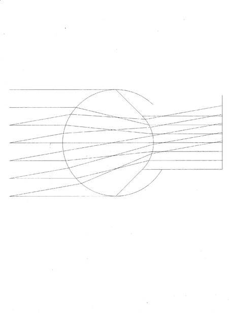

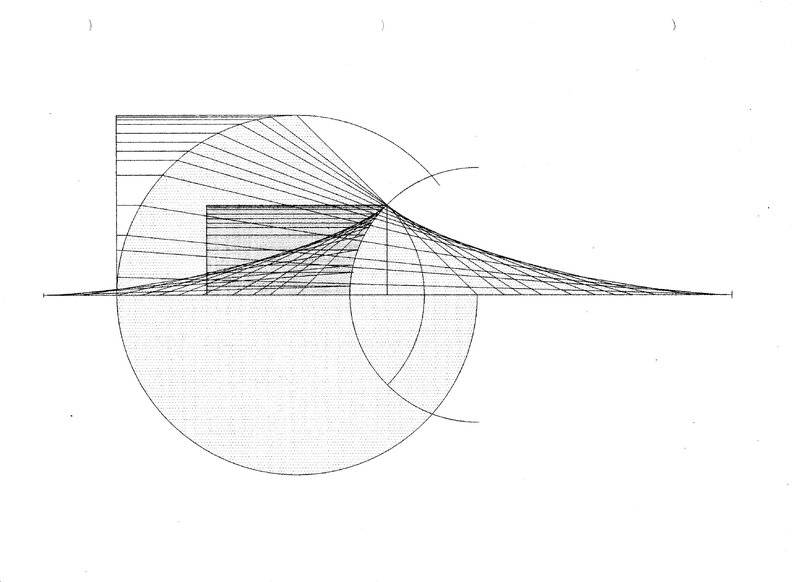

Here's a couple more plots to show more examples for your consideration.
Ray diagram of a spherical lens with parallel horizontal rays entering from the left, focused through the sphere, then exiting into a hatched layer and emerging as parallel rays on the right.
Ray diagram of a spherical lens: a fan of rays from a point on the axis refracts through a circular spherical surface, with a second focal point and curved boundary lines drawn in black.

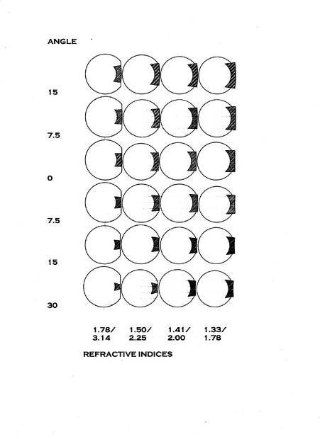

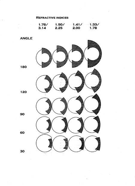

If I may add just a few more pictures, it should let you see what these might look like. The first diagram again for clarity, with the equations shown, and also an array of cemented doublets in sequence with incident angles and first and second radii shown. The third,
Ray diagram of a spherical lens surface with several rays entering from the left, with two equations below: r2 = r1 x n0 / n1 and n0/n1 = n1/n2.

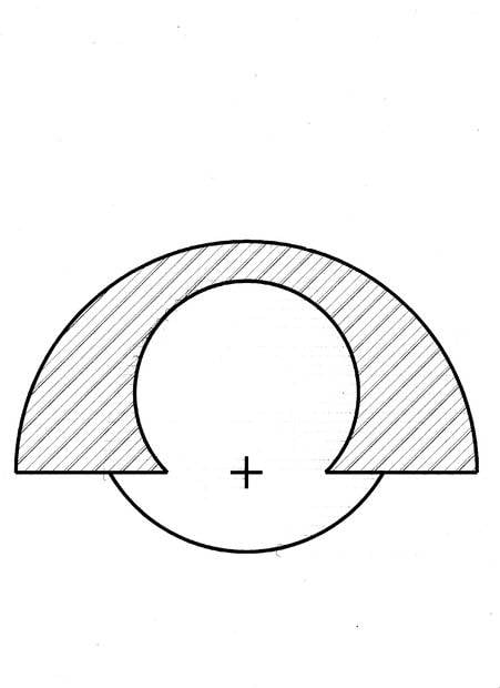

Grid of circle diagrams with hatched crescent shapes, columns headed by refractive index pairs 1.78/3.14, 1.50/2.25, 1.41/2.00, 1.33/1.78 and rows labelled by angle 30, 60, 90, 120, 180.
Grid of six rows of circles, each with a hatched or shaded crescent-shaped region on its right side, labelled by angle (30, 15, 7.5, 0, 7.5, 15 and 30 down the rows) and by refractive index pairs such as 1.78/3.14, 1.50/2.25, 1.41/2.00 and 1.33/1.78 across the columns.
last radius for the doublets is arbitrary.

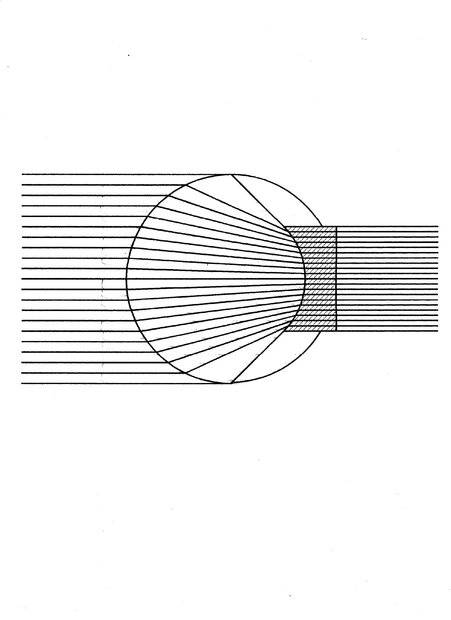

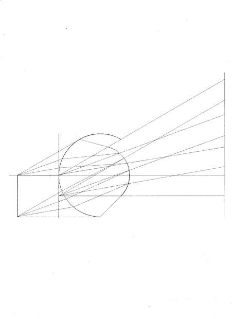

Here's a last picture for the week, if no complaints yet. Thanks. A sequence showing rays and some ray extensions, both front and back. First index is the square root of 2 again. Angles given are for half-waves. (Angles in the last big array posted were full wave values.) Incident angle of waves not to be confused with incident angles in the law of refraction at the surfaces. Will you all agree yet to zero SA for this model?
Five ray diagrams of a sphere with rays converging to focal points at different distances, with fan-shaped ray bundles and shaded wavefront regions; labels include 30 and 15 near the focal points.
If that is what the math says then I agree with it. However, note that we really don't have a singlet anymore. That typically implies a single lens inside a single medium such that the refractive index on both sides is the same. You've essentially made a cemented doublet.
Yes, I agree with you that this is not a singlet that we typically think of as a lens immersed in a single medium. Defined like that, it's not a singlet, no. So, it's really a cemented doublet when capped off. That's OK, too. It still disproves the current thinking, as expressed in Hecht's quote pertaining to spherically surfaced lenses not being able to zero SA. Thanks for all your needed clarifications.
Yes, I think those first two equations hold for all the waves up to the aplanatic point, for all the calculating I've done to check points plotted in the pictures.
So, this should be big news for physics, geometrical optics and Huygens, and I hope someone as yourself or one in your audience, can made good use of this model. It should have been found about 350 years ago. Huygens had the geometry then and the second radius.

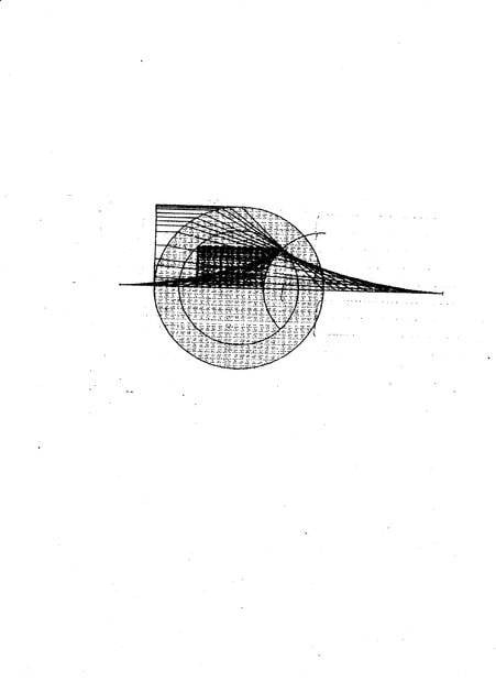

The model is an odd apple, for sure, if you've never seen it. The pictures are for full waves too. Actual uses would probably be for smaller areas nearer the central axis. A couple of off-axis plots can help you see more.
Ray diagram of parallel rays entering a circular spherical lens from the left, refracting through it and converging toward a vertical line on the right.
Hand-drawn ray diagram of a spherical lens with rays from a point object on the left refracting through the lens to a vertical line on the right.

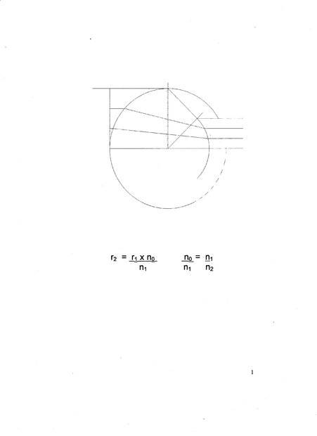

Drakkith said:
Forgive me, I haven't taken optics in years. If there is a sine somewhere in there it would help if you explicitly posted it.

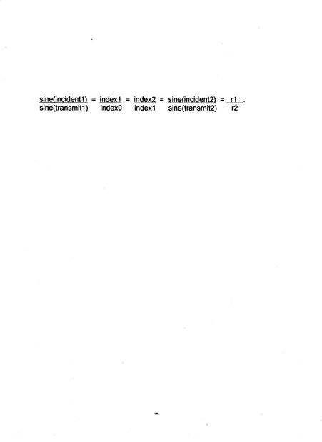

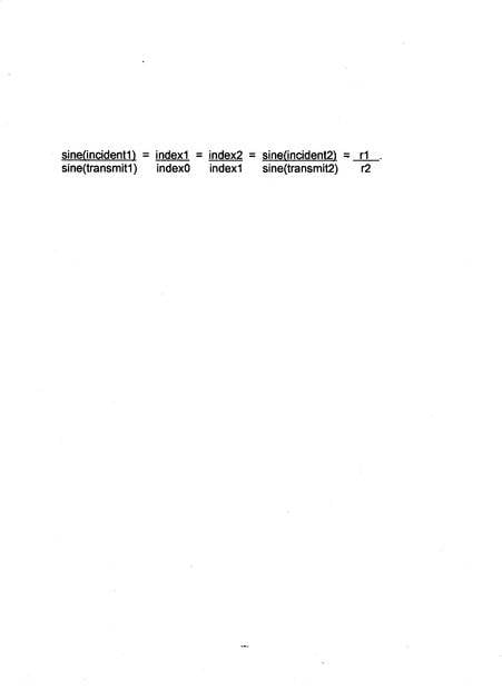

Here's the missing sine laws I confusingly left out of the equations first posted for this model. Here's all the relations now. They all have the same value, that of the refractive ratio. Square root of 2 here in the diagrams. Surface angles are now included for the two surfaces.
sine(incident1) = index1 = index2 = sine(incident2) = radius1
sine(transmit1) index0 index1 sine(transmit2) radius2
It's easy enough, basic, really, but not trivial, I agree.
  • Handwritten chain of equalities: sine(incident1)/sine(transmit1) = index1/index0 = index2/index1 = sine(incident2)/sine(transmit2) = r1/r2.
