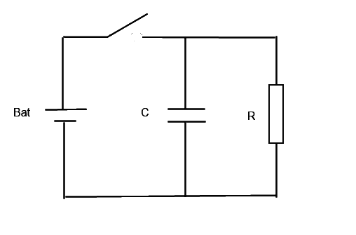

Just to add it's quite common to change your view of how a circuit is configured... For example in this circuit when the switch is made you might choose to analyse the R and C as being in parallel with each other and the battery. Then when the switch is opened it makes more sense to view the C and R as being in series with each other.
