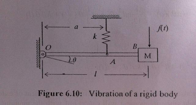

Hello guys. Really need your helps. When I construct an equation(moment about point O), do I have to include the rod's mass also? I've heard that I can neglect the rod's mass due to equilibrium equation. On the other hand, I've also heard that I can only neglect mass if the point of mass is supported. Appreciate if you could show me the equation. Thanks in advance. * For some reason I cannot attached the image.*
You have not supplied the geometry.
Is this a mass on the end of a rod, with the pivot at the opposite end of the rod to the mass?
If you suspect you cannot neglect the rods mass, do the calculation both ways and see what difference it makes.

You may neglect the moment of inertia of the rod if it is significantly smaller than the moment of inertia due to other objects in the system -- in this case, the M.O.I. due to the mass M. Usually, a problem statement will say either (1) the rod has negligible mass, in which case you can neglect it's mass and M.O.I., or (2) provide you with the mass or M.O.I. of the rod, in which case it should be included in the calculations.

Oh I see now - it's a weird mass-on-a-spring ... probably they only care about the lever-arm effect for the rod.
Ive gone through every material that I have. Please correct me if I am wrong. Based on the rod(attached image), we can create and equation (Moment about point O = I\alpha). From my understanding, We can canceled out Moment about point O of rod's mass (mg*l/2) due to mass*acceleration effect on the other side of the equation. Please enlighten me.
Well just write out the sum and see ... assign a mass m to the rod.
(Note: if the problem does not give you a mass for the rod, it is probably negligible.)
To me it looks like your photos contain terms from the rod for each example.
