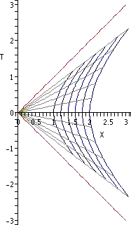

I am trying to understand things around singularities and related to this I have a question.
What kind of singularity is Rindler horizon?
Wikipedia (Rindler coordinates) says that: "The Rindler coordinate chart has a coordinate singularity at x = 0,"
But if Rindler coordinates are not defined on the other side of the horizon then they are not related by bijection to inertial coordinates. And then Rindler coordinates do not cover region around x=0 from the other side (I believe this is requirement to state that x=0 is coordinate singularity).

A coordinate singularity, just like Wikipedia says.
No, it isn't. Defining a coordinate singularity can be done without any information at all about what other charts the Rindler chart has a bijection with, or even what other points besides x = 0 the chart covers. The reason x = 0 is a coordinate singularity, as the Wikipedia page says, is simply that the metric tensor has vanishing determinant there. That's all. And this fact can be calculated purely from the metric coefficients at x = 0, without any other information required.

If we restrict attention to the subset of spacetime where x > 0, there is a bijection (one-to-one mapping) between Minkowski coordinates and Rindler coordinates. If you try to extend the subset to include all the events where "x = 0" you no longer have a bijection.
Note: throughout this post I have been using the notation of the Wikipedia article Rindler coordinates.
DrGreg said:
That's what makes it a coordinate singularity, the fact there isn't a one-one mapping at x=0.

One can see from the plot that Rindler coordinates only cover 1/4 of space-time.
One can play around with extending them, but I'd rather not be responsible for any physical confusion one may get as a result. I don't see any obvious way to make them cover more than 1/2 of space-time in any event - they currently cover 1/4.
