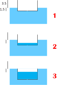

  • #48
a/ Show that difference between the levels inside and outside the ship is not changed.
without hole...outside 1,5m, inside 0
Water flows in1 m...outside 2,5m...inside 1m
ship sinking...outside 5 m..inside 3,5m
...level difference is always 1,5m?
can I prove it generally?

  • #49
charlie05 said:
Archimedes' principle without hole...M*g = A ( h0)*ρ * g
In post #19 I wrote ho, not h0, as being the height of water outside the boat relative to the hole. Your equation is correct, but ho is a variable. Aho is the volume displaced at any time, not just at the start.
charlie05 said:
Archimedes' principle with hole...M*g + mg = FB = ?
Write m in terms of hi, A and ρ. For FB, use the volume displacement mentioned above.

  • #53
Dear Charles,
Your exercise is very helpful in part a) by positioning you on the track
charlie05 said:
(h0-hi) is constant
It should dawn on you why that is so. And for that, what you really want is a graphic screenplay of this Titanic disaster,
properly embellished with symbols for ##h_*## (I leave that to you)
Here is my artistic rendering, and as you see, I already cashed in on the one item that you are asked to prove:
Note that the darker blue only distinguihes water inside from water outside: its ##\rho## is the same (hint hint)
  • #54
thank you for the sketch, I can now imagine it, it is clear...
h0utside-hinside = 1,5m constant, in all cases
  • #55
That's how I suggestively have drawn it -- can you explain why it is so ?
  • #56
because there is still a buoyant force an empty ship?
amount of displaced water is about (A * 1.5) m3 greater than the volume of water into ship
Are posts 50,52, 54 right or not?
