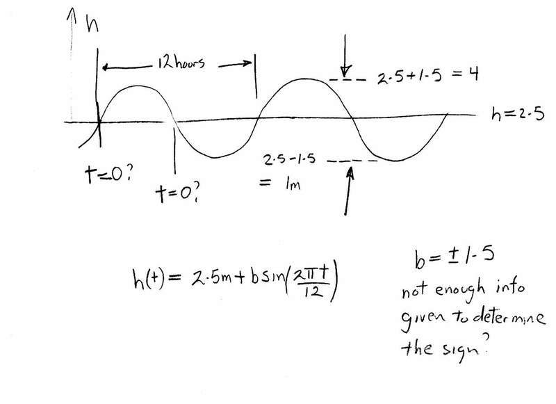

Measurements of the height h(t) of water in a harbor are recorded ,where h is measured in meters and t in hours.It was noted that the rise and fall of a tide is modeled by a sinusoidal function giving the height by : h(t)=a+bsin(kt+c).
(a) Obtain values of the parameters a,b,c and k if measurement started when the level is equal to the mean level of 2.5 meters and has an amplitude of 1.5 meters and a period of 12 hours.
b) Compute the rate of change of the water height.
c) Find the highest and lowest values of h and the times at which they are taken.
This is a very complex problem (I think). OK, I tried to solve it in many way but with no progress, finally the doctor said that he will give us a hint. So I wrote this hint and I found it was very far from my attempts to solve it.

Does this get you started?
