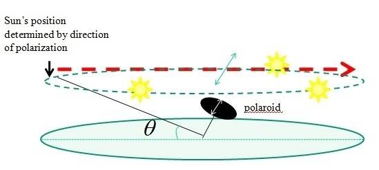

im studying polarization, and i want to check if i have the right idea about sky polarization.
basically i want to find the position of the sun when i know the angle theta (refer to the attachment) of the sun but doesn't know the exact position.
so i look at the portion of the sky that is at the right angle from the plane of the sun and rotate the polaroid and find the axis of the polaroid when it's the brightests.
so from this, i assume that the polarization direction by scattering is in the same direction as the axis of the polaroid and therefore determine the position of the sun as shown in the picture.
do i have the right idea?
and also, i actually tried to find the sun's position myself with a normal polaroid.
but when i looked throgh the polaroid and rotated it, there wasnt any difference in the brightness of the polaroid. what is wrong with my approach in this experiment??
is the linear polarization by scattering usually not strong enough to detect by a normal polaroid? if so, how can i design the experiment?
Yep.
The sky polarization is very sensitive to aerosols (water vapor, for example) and pollutants: without knowing more, I can't guess why you did not notice any change. On a clear day, it's a very pronounced effect:
http://farm1.static.flickr.com/6/86864348_ed115c64fb.jpg
It should be possible, many insects use this technique for navigation.
