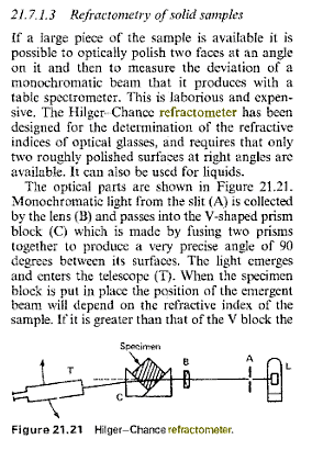

Aha! I found the magic reference:
Methods in High Precision Refractometry of Optical Glasses
Alan J. Werner May 1968 / Vol. 7, No. 5 / APPLIED OPTICS 837
The V-block method is given it's own subsection, and has nothing to do with Pulfrich! Here's the original source:
J. V. Hughes, "A new precision refractometer", J. Sci. Instrum. 18, 234 (1941).
So it is relatively new; strange that it is present in so many places. My guess is someone mistaken these two designs when writing a book that became popular; after that everyone just copied the error.

And when you think you finally know something, you look into Walt Boyes Instrumentation Reference Book to find this:
So here it is Hilger-Chance. What a mess.
Sheesh!
"The Hilger-Chance refractometer, developed initially in the laboratories of Messrs. Chance Brothers Ltd.,[HUGHES J,. V. J. Sci. Instrum., 18, p. 234 (1941).]" and Hughes' paper is called "A new precision refractometer".
