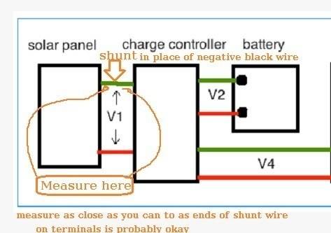

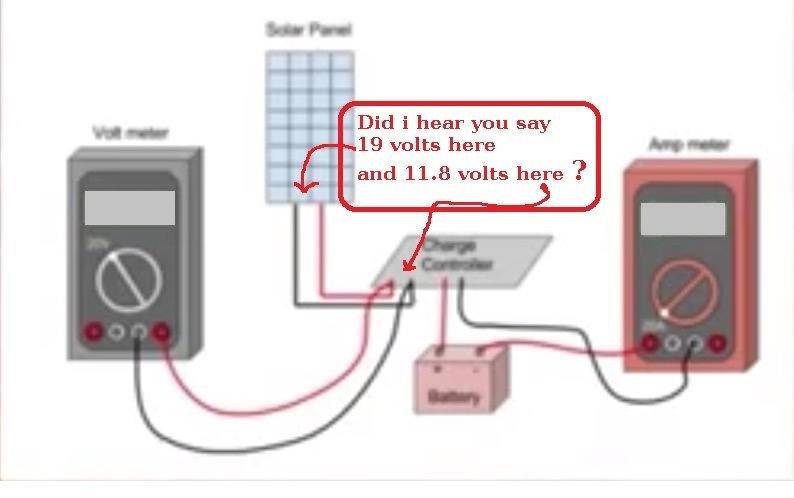

When multimeter hooked directly to panel it shows around 19v. When I hook multimeter up to where panel goes into solar charge controller it shows 11v? That is also the reading you get when hooked up to the next terminals which are the battery connections.
anorlunda said:
A PWM charge controller does absolutely nothing when the voltage is below 13.8. The controller is not a big source of inefficiency, it doesn't contribute inefficiency at all as long as the battery is undercharged.
Is this the reason for the slow charge? Where/why is there a dropoff in voltage? I would have expected the first terminals to still show 19v and the battery terminals to show whatever the batteries current voltage is?

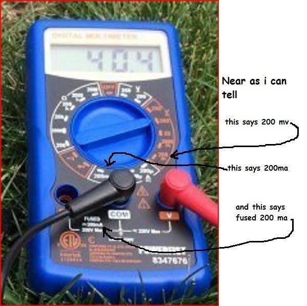

  • #36
Wolst73 said:
OmCheeto, post: 5510606, member: 103343"]Simply hook your panel directly to the LED system, without the battery.
Then let us know what the voltage is.
Solar Panel hooked directly to DMM showed 19.4V.
Panel hooked directly to Vin on led driver and DMM hooked up to Vout showed 40.4V
And I thought my numbers were goofy.
40.4 volts * 0.7 amps = 28.3 watts
Didn't you say your LED's were 18 watts?
And didn't you say your panel was rated at 20 watts?
Is it a fair guess, that you didn't hook up your LED's?
Maybe this will shed some light on the problem?
You really need another meter...
Right there's a mighty strong clue...

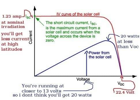

  • #39
Think of the PWM controller as an automatic on/off switch. At say 13.7 battery volts and below, it is ON 100% of the time. At 13.75 volts it is ON only 50% of the time (switching ON/OFF perhaps 10 times per second). At 13.8 volts and above, it is OFF 100% of the time.
You should have nearly zero voltage difference between the panel and the panel-side of the controller. If that is not the case, then there is a bad connection, or a damaged wire, or a seriously undersized wire.

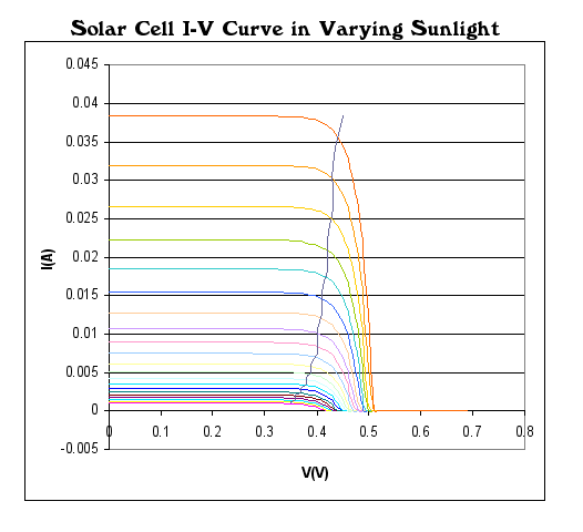

FYI, but not part of your problem: The panel itself is highly nonlinear. The following graphic shows the voltage-current curves for a single cell. Each curve is for a specific sunlight strength. Panels are made with many cells, and open-circuit voltages 14-45 volts. The wiggly line shows the maximum power point which is the optimum operating point. MPPT controllers (which cost $100-$150 more) automatically track the optimum.
Same part of wire used for testing direct from panel that is in the controller so shouldn't be that. Bad connection inside controller? This is the second controller I have bought. First one didn't power on at all. Aargh. Does anyone have similar controller that can reproduce my test and get the expected results?
  • #41
anorlunda said:
What you say is correct, but there are other factors that can't be compensated by attitude tilt angle of the panel. The seasonal variation in daylight hours is one.
Sure, forcing solar collection down to useless in high latitude winters, but since Russ posted and you responded to him personally we're not discussing the annual case, we're discussing the ideal summer day case Russ posited. I added the qualifier of in the US to not waste time with extreme latitude cases (where nobody will be installing solar farms)
  • #42
19V at panel, 11V at charger ?
Time for a sanity check.
To expand on anorlunda's suggestion
take one of your voltmeter probes in each hand.
First: place one probe on + terminal of solar panel and other probe on +panel terminal of charge controller (leftmost one)
If you read 0.0 volts that's good
if you do not read 0.0 volts you are indicating voltage across that wire which isn't really possible. A few millivolts maybe but not hundreds or even tens of them.
Second: place one probe on - terminal of solar panel and other probe on - panel terminal of charge controller (next to leftmost one).
Assuming both those tests come out okay
repeat your voltage readings across the solar panel terminals and across the charger controller's panel terminals.
If you once again do not get the same reading both places then please advise so we can help you figure out why Kirchoff has abandoned you.

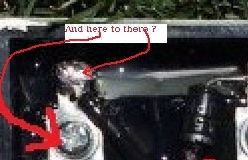

old jimFor next post so i don't misplace it...
Well, I'm getting to long shots.
This is from datasheet at
http://en.ueiua.com/supply/11.html
Sequence of hookup ? Panel before battery, sees 19 volts so sets itself for 24V ? Try disconnect everything, hook up battery first.
also it's a PWm so may draw its current in gulps instead of constant. Try a few hundred microfarads across its panel terminals.
  • #43

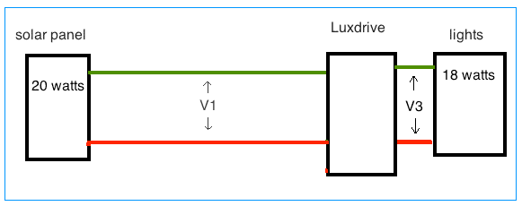

OmCheeto said:
Somewhat. I'm guessing you did not have it hooked to the battery.
Battery was hooked up. Red light was on on controller (couldn't see in pic). Green light showing power from solar panel.
Lux drive is hooked up to charge controller. It will show 0 because controller won't switch to load when battery is low and is getting enough power from solar panel. I will unhook it from controller and wire directly to battery tomorrow and report.
  • #46
Wolst73 said:
Sorry. You are dealing with an extreme rookie when it comes to electrical. Thought you meant to see what voltage was coming out of the driver. Where do you want me to hook up meter? 6-3w led wired in series.
Measure the voltage everywhere, with EVERYTHING hooked up: Solar panel, charge controller, battery, Luxdrive, and lights.
Lights on. Sun shining around noon. Panel facing sun, with NO shadowing.
According to my diagram, you should have 4 different voltages: V1, V2, V3, V4
Did the results above with regards to the charge controller make sense to you?
The controller would sense that, and is probably designed to provide "dead battery" voltage, which according to Battery University, is 11.89 volts.
Which is very near the 11.67 volts you have displayed.
Then I'm now guessing your battery was like the wicked witch, really most sincerely dead.ps. Sorry about the time traveling, but I noticed my original schematic was wrong.

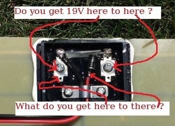

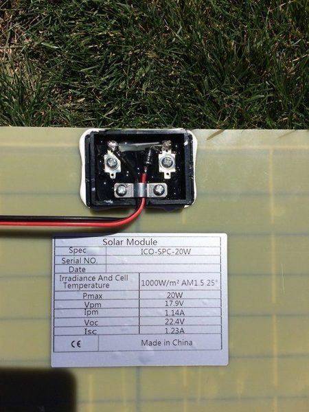

  • #47
Positive terminal was 0.23v
Negative terminal was 0
Panel by itself: 20v
Panel hooked up to charge controller (V1): 11.6v
Battery terminal/battery charge controller (V2): 11.6v
Led drive connected to battery, lights on (V3): 19.2v
V4 I can't measure because controller won't switch to load if battery is low (or I don't know how to force it to).
Tried the other charge controller (which I said earlier didn't work). Apparently this one you have wait a few minutes before it turns on. Other one was instant. Same results for V1 and V2.

Tried covering half the panel with some cardboard. Reduced panel voltage to around 15v. Now V1 shows only 9v and V2 is still 11.6v.
  • #49
Our posts crossed in the E-wind. You're headed in the right direction.
Wolst73 said:
Hmmmm... 0.23 volts something is bad wrong with that + wire... Look for a tiny piece of insulation under one of your screw terminals. late edit turned out the 0,23 volts was the blocking diode in series with red wire
Might be an intermittent ? Wiggle the wires.
( i hate to ask this- don't be offended...
You did skin the wires, didn't you? My sister had an MG automobile with repeated taillight problems until we figured out the factory guys hadn't stripped the insulation off the wires before attaching the push-on terminals. Taillights only, musta been a new guy.)
Sometimes a wire will get stretched and break most of its internal strands. Feel it for a spot that's thinned or soft.

If you look at these curves from #39 again, you can see that dropping the panel volts from 19 to 12 means that it is pulling nearly short circuit current. (The difference between rated current and short circuit current is small. You can see that on the nameplate sticker on your panel.)
https%3A%2F%2Fupload.wikimedia.org%2Fwikipedia%2Fcommons%2Fd%2Fd8%2FSolar-Cell-IV-curve-with-MPP.png
That raises two questions.
  1. If the panel is sending 1.2 amps, and the voltage drop is 0.23 volts, then the resistance of the connection is 0.19 ohms. That's too much resistance. Either there is a bad connection or an inadequate wire. 0.19 ohms is the resistance of about 12 feet of 22 gauge wire. 22 is far too small a gauge. 18 gauge wire gives about 1/3 as many ohms per foot. 16 gauge wire 1/4 as much.
  2. If more than one amp is going to the battery and the battery voltage is still less than 12, the battery is definitely bad (probably a cracked lead plate). Don't you have any current measurements? If you buy a replacement, make sure it is deep discharge battery. Also make sure all the wires in your project up to the Luxdrive are also at least 18 or 16 gauge, and make them only as long as necessary.
Edit: On second thought, if you buy a larger deep discharge battery, it too is likely to become sulphated. To minimize supplication, you would have to fully recharge the battery on the first 2 hours of peak sunlight each day, and leave it on a float charge for the other 3 hours per day. (At 49 north, you may not have many peak hours of solar in December).
I repeat my earlier recommendation, Nicad or Lithium batteries are better suited to your application.

It says the controller does not immediately accept any current . One presumes the computer is in control of that..
And - your photo explains the 0.23 volt drop in + wire, it's that black diode with red wire soldered to it.
So - why does voltage drop to 11.6 , same as battery, yet we think battery is not getting charged ?

Hmmm nameplate says short circuit current is only 1.23 amps

I blew up that picture with your DMM in it.
Your DMM looks like its highest current scale is 0.2 amps and we don't want to blow the fuse that's inside of it.
So we can't just set meter for amps, hook it across the panel and uncover like you just did for volts (which was a great test by the way)
But we could put a shunt across the panel and measure voltage across the shunt.
Does your meter have a 200 millivolt scale (or 100 millivolt) ?
Do you have access to some small wire, # 20 or #22 ? That'll make a primitive shunt.
#20 is 10 milliohms per foot, #22 is 16 milliohms per foot.
Ten feet of #20 would make 100 milliohms, a 1/10 ohm shunt

Then i'd move my shunt to the far end of those two wires intended for panel controller, twist it to the red and black from panel but don't connect them to controller
and repeat the test, again measuring voltage right at the shunt
That checks that the diode and wires are capable of carrying an amp from the panel to their far end where the controller is
0.2 Amp? I'm sure I've blown the fuse a while ago then. What's the point of making a DMM that measures so little? Granted it was only about 30$.
It's cheap. A ten amp high energy fuse that's safe at your meter's 350 volts is expensive so they don't put a ten amp scale on many DMM's

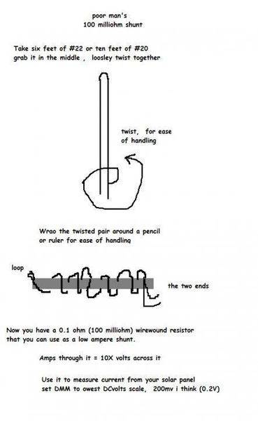

Here's how to make the shunt out of plain old wire
be aware it's not terribly accurate and as the wire warms it changes resistance by copper's temperature coefficient, about 0.4% per degree C
but this ain't the Steinway factory... ±a few percent will do us fine.
For step 1
you'll connect the two ends of your shunt across your solar panel terminals and measure voltage across the terminals
For step 2
you'll twist the two ends of your shunt to the far end of the panel's red and black wires and measure voltage there
For step 3
you'll hook the two ends of your shunt to where you unhooked the black wire's two ends from panel and controller
use the shunt instead of the black wire so you'll know how much current is flowing there. You'll have to unwrap a few turns and untwist them to reach I'm sure.
I hope it tells us a lot
old jim
edit oops i see the red and black wires are soldered to the panel
so you won't remove the black wire just tape its loose end
and use your shunt instead of the black wire

Probably dumb question, but is the shunt bare wire?
These voltages look like what I would expect.
Good catch!
Yes. That is a dumb question.
not at all
you'd best use insulated wire. Else it'll short out every place it touches .
Bare would be best for heat dissipation, but with any length keeping the copper conductors from touching one another as we twist and wind it becomes impossible..
A proper shunt is made from a short length of some metal with zero temperature coefficient, manganin is popular. You can buy low ohm resistors made for current sense but i assume you're not close to an electronics supply house.
http://powerelectronics.com/passive-components/current-sense-resistors-heed-call-more-power
The reason for grabbing our wire in the middle to make it a double conductor is so it will be non-inductive when we coil it.. After you wrap it around the ruler , current will flow around the coil clockwise in one half the turns and counterclockwise in the other half, so the magnetic fields cancel. See :Right Hand Rule".
Twisting them together makes it easier to handle.

Can diagram be adjusted to show where I am to measure with multimeter? (sorry Jim)
  • #60
test 3: Borrowing from OM's diagram of post 46
Green is usually negative... so i drew shunt there
sorry for low quality
i'm not much good with graphics and MSPaint is torture.
Good Luck !
