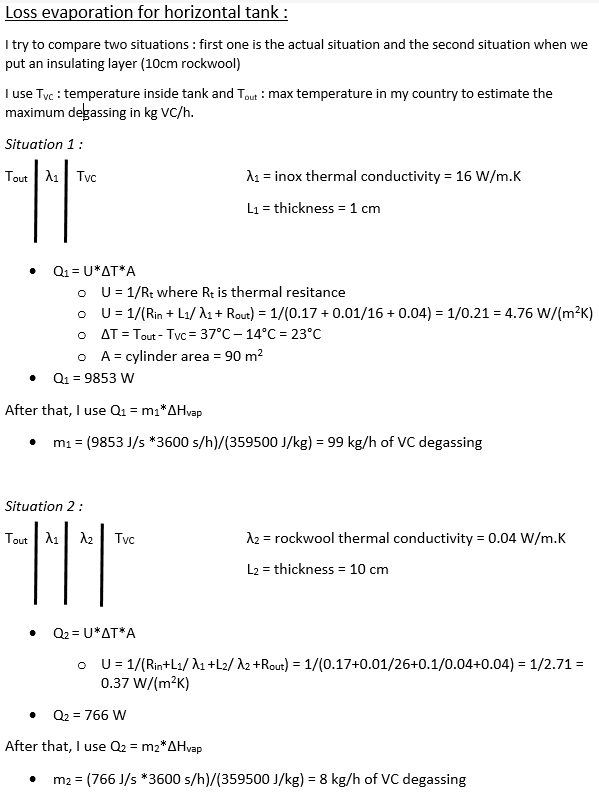

After some research, I do these calculations...
It looks okai. But I still need to include the effect of solar radiation...
Thanks for your time...

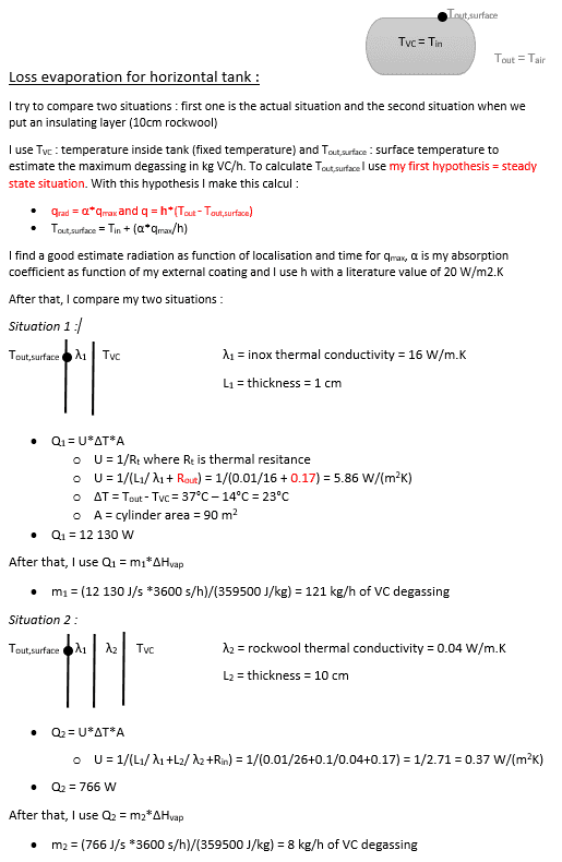

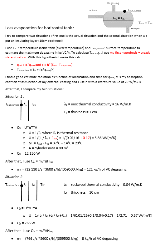

Hello, I update my calcul if someone is interested.
I juste have two questions : My way to estimate my outside surface temperature seems okay ?
And I have a big problem to estimate an average convection coefficient for both situation : (h_out in my first calculation (1/h_out = 0.05 m2.K/W) and h_in in my second (1/h_in = 0.17 m2.K/W). These coefficients change a lot the final result and I am not sure about my values (I just use theoretical value find in literature...).
Thanks a lot.
The key to this is to look at a worst case scenario, using upper bounds to the inside and outside heat transfer coefficients. That way the calculation should be conservative, and give an upper bound to the evaporation rate. I think your value for the inside heat transfer coefficient looks low. I would use a much higher value, on the order 500. Your outside heat transfer coefficient looks reasonable. Considering that, in the actual situation, the insulation is going to dominate, I guess these values wouldn't matter much.
