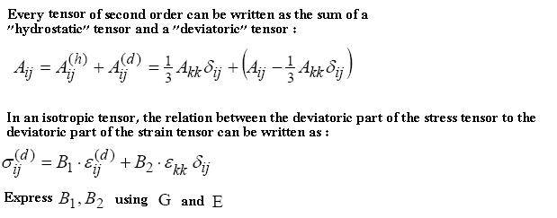

I got 3 new questions that need to be solved in about 3-4 days as part of a 'challenge' homework. Those who solve correctly will basically get their names read out loud on the next lecture but I do it to understand the material of the course
First Question:
http://up185.siz.co.il/up3/n2i5uwddmczo.jpg
I first tried to write all that I think that has to do with the questions, expressions that I learned and think that I'll use.
Then I thought of first expressing E1111 but then I figured there's no need to.
How do I express E'1111 ? do I use the last formula (transition formula) first?
The solution doesn't involve any sines or cosines (or trigonometry at all). It's hard to say more without giving the "Aha!" away.
My thoughts are that I should find E1111 and then E'1111 will be equal to E1111 since the stiffness matrice E does not change from one system to another (?)
Agreed, because the material is isotropic.
Thanks!
