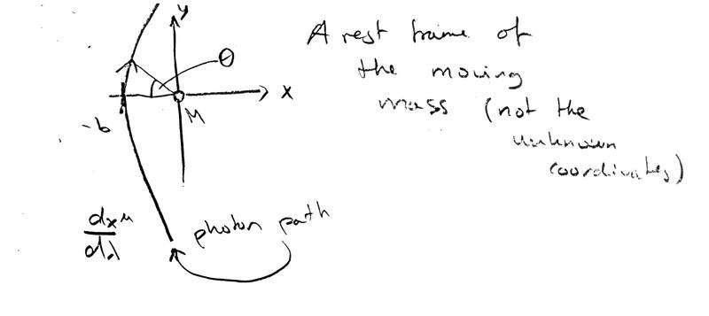

Ok, I have been working away at this. I found the metric in the non moving frame. But how do I go from there. Suppose I write the up the geodesic equation or equations for conservation of momentum along a geodesic
0 = g_{\mu \nu} \frac{dx^\mu}{d\lambda}\frac{dx^\nu}{d\lambda},
We don't have an equation for ##\frac{dx^\mu}{d\lambda}##? How can we find this quantity in the unknown coordinates when they are unknown? Here is a drawing of the situation
I'm confused. The coordinates your metric is written in are, ##x##, ##y##, ##z##, and ever popular, ##t##. Again the ##g_{\mu \nu}(x,y,z,t)## you've given is that of a mass at the origin for all time, ##t##. This is about as "stationary" as it gets for mass ##M##. So, you are looking for 4 functions, ##x(\lambda)##, ##y(\lambda)##, etc. where ##\lambda## is some handy parameter you are free to choose. Now, as an added confidence builder, I've never solved this problem myself (that I recall). There have to be an quite a few of these solutions because every light ray possible obeys the equation you've given. You need to pick the one that of these meets the initial conditions you've also been given. Oh, it's time to drop the general index sums and write out the equation to be solved using your particular metric.
[edit] You might try a simpler metric ##g_{\mu \nu} = \eta_{\mu \nu}## first. What do the geodesics look like for this case?
Hey, is the equation you've given the "geodesic" equation? I thought it is something like,
##\frac{d^2x^\mu}{d\lambda^2} = \Gamma^\mu_{\alpha\beta}\frac{dx^\alpha}{d\lambda}\frac{dx^\beta}{d\lambda} = 0##
what gives?​
I added a drawing to my previous post. There are three sets of coordinates.
(1) ##(t,x,y,z)## as I have drawn in the picture above
(2) ##(t,x^1,x^2,x^3)## where the mass is stationary
(3) ## (t,\zeta^1,\zeta^2,\zeta^3) ## where the mass is moving.
It may well be that ##(t,x,y,z) = (t,x^1,x^2,x^3) ##, but it is really difficult to tell from the problem.
