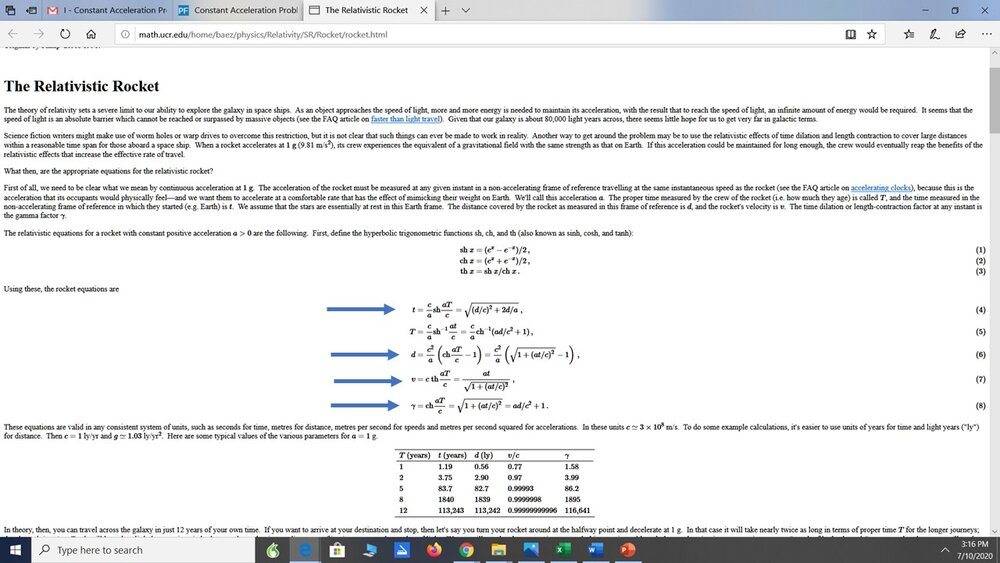

I did have one question about the formulas on the page, though. I attached a picture. For the equations that have a blue arrow next to them that I put in, how do you get from hyperbolic functions to square root expressions? I thought maybe at first the author did some kind of expansion but I couldn't be sure.
Just by eliminating between the expressions, I think. For example, using that ##1=\cosh^2\theta-\sinh^2\theta## you can substitute the expression for ##d## in terms of ##\cosh## into the expression for ##t## in terms of ##\sinh## to get the square root expression.
By substitution. Note that the square root expressions don't have all of the same variables in them.
For example, the first equation is
t = \frac{c}{a} \sinh \frac{a T}{c}
Multiplying the second equation by ##a / c## (and using the far right equality of that equation) gives
\frac{a T}{c} = \cosh^{-1} \left( \frac{ad}{c^2} + 1 \right) =
Therefore we have
t = \frac{c}{a} \sinh \left[ \cosh^{-1} \left( \frac{ad}{c^2} + 1 \right) \right]
Which, if you make use of the formulas for composition of hyperbolic trig functions, will give you the formula for ##t## with the square root in it.
Yes, I got it. Just needed a little help. I could derive them from the hints given here. All good to go.
