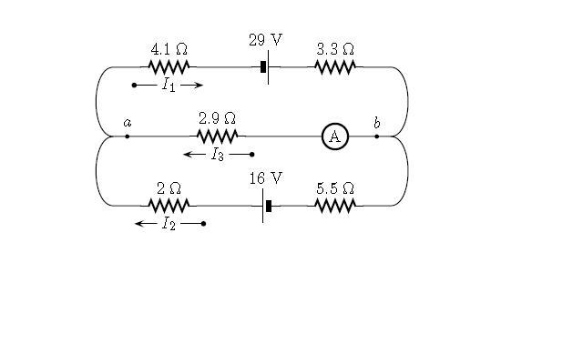

Solve Currents in I3, I2, and I1
  • Thread starter itryphysics
    Currents
itryphysics
114
find the current in I3 and I2 and I1
junction Rule
Loop 1 : -I1(4.1) + 29V - I1 (3.3) -I3(2.9)
-I1(7.4) -I3(2.9) = -29V
Loop 2 : I3 (2.9) - I2 (5.5) +16 V - I2(2)
-I2(7.5) + I3(2.9) = -16 V
Loop 3 : -I1(4.1) + 29V - I1(3-3)-I2(5.5) +16V-I2(2)
-I1(7.4)-I2(7.5)=-45V
Please help ASAP thanks!

Hi itryphysics! :smile:
(The third equation gives you no extra information …
it's just the sum of the first two equations …
the number of independent loop equations is the same as the number of independent loops. :wink:)
You've headed this "junction rule", but you haven't used the junction rule, only the loop rule.
