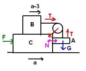

Block C (m = 4 kg) sits on a frictionless horizontal surface. Block B (of m = 2 kg) sits on top of block C, and is attached to a rope that runs over the massless
pulley as shown in the figure. Block A (m = 1 kg) hangs vertically from the rope. With
what horizontal force F must you push Block C so that block A rises with an upward
acceleration of a = 3 m/s2? All surfaces are frictionless.
(a) 12 N
(b) 47 N
(c) 59.8 N [itex]\leftarrow[/itex] This is apparently the correct answer
(d) 15.0 N
(e) None of the above
Figure:
http://www.freeimagehosting.net/t/28bdd.jpg

robkom said:
(Viewed as a system)
F = (mA + mB + mC)a
It is wrong. There are two external forces: F and the weight of A, and the blocks do not move with the same acceleration.
Draw the whole FBD and write out Newton's second law for each block.
ehild

robkom said:
Blocks C and A accelerate to the right at the same rate. And blocks A and B accelerate at the same rate. And when viewed as a system, the whole thing accelerates to the right at the same rate. No?
No. B accelerates with 3 m/s2 with respect to C backwards. So its acceleration is ac-3.

robkom said:
I tried it again, keeping in mind what you said, and now I got 47N, which is in the list of possible answers, but is not the correct one.
I drew full FBDs for each block and the system as a whole.
I would like to see your FBD-s. No need to draw an FBD for the system as a whole, as it is the resultant of the separate FBD-s, with only the external forces: F and the weight of C, which determine the motion of the CM of the system.
I show you the forces in the figure. Collect all forces acting on each block. The resultant is equal to the acceleration times mass of that block. Take care on the direction of forces when you write the equations.
ehild

See my picture: The cord acts also on block C. The chord presses the pulley and the line of the resultant force goes through the axis of the pulley which is fixed to the block. This force has to be taken into account.
The horizontal forces on block C are: F-FAC-T. Try again, you will get the correct result.
This was a really tricky problem!
ehild
