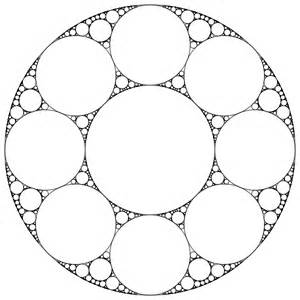

What is the next radius outwards of this Apollonian gasket?
th?&id=OIP.Me9c0c5c93c2ef6467e1d285d31f776b0o0&w=300&h=300&c=0&pid=1.9&rs=0&p=0&r=0.jpg
R = radius of outer circle = 5
r1 = radius of largest inner circle = 3
r2 = radius of second largest inner circle = 1
a = unknown radius

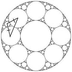

Here is what I am trying to compute:
That part of the isosceles triangle that is inside that smaller circle, that is the unknown radius a. I know it is a rough drawing but that longer side is d which in this case is 2 and that smaller side that makes it isosceles is r+a which in this case is 1+a
So I am setting the perimeter of that triangle as x.
But when I try to solve for x in order to find that unknown radius by first solving for the unknown radius in terms of x and then substituting, I get -1=0 which is obviously wrong since for 1 thing, a circle can never have a negative radius and another is that the statement itself isn't true. It is like saying that you can divide by 0 in normal mathematics. Obviously false.
The only other thing I can think of though would be either the altitude of the triangle or the area for finding that unknown radius and I don't think either one is going to be of much help.

Your diagram looks wrong to me. Shouldn't the circle of radius a be tangent to the outermost circle?
No because that is not the case for this kind of Apollonian gasket. It is actually the next layer that is tangent to the outermost circle
Anyway, why does that make a difference? I would still be using the perimeter of the triangle to solve for the unknown radius. So basically in this kind of Apollonian gasket, if multiple circles are touching the outside of 1 circle and going outwards from it like in the layer right next to the center circle, those are tangent circles. If it is the other way around that the same circle is touching multiple circles a layer before it like in the case of the circle with the unknown radius, that is not a tangent circle.
So while yes, the circle with the unknown radius is touching tangent circles, it itself is not a tangent circle.
And what I mean by a layer before it is the closest circles of a larger radius not taking into consideration that outer circle.

Suppose we try to generate the diagram thus:
Draw the innermost circle.
Draw eight circles around it of the right radius to fit.
Draw the outermost circle tangent to those.
Draw the circles radius a, where a is any value less than that to make them tangent to the outermost circle.
Proceed to fill in with circles of the max possible radius everywhere.
There is a place where this procedure breaks down, and this is the key to determining a. Where is that?

That does not quite do it, since ordinarily you would simply adjust those.
The key is that there are exactly six smaller circles tangent to it and to the outermost circle. That fixes the size of a, relative to the larger circles.
Note that the same happens between the innermost circle and the eight surrounding it, but how that turns into a general algorithm I have not figured out.
It occurs to me that the same principle applies to the innermost and outermost circle, and the eight tangent circles they share. The relative radii of these ten can be computed from that, but these do not match to the given ratios. They involve cosec(π/8). Where did you get the radii 1, 3 and 5 from?

@caters, are you familiar with the equation that relates the radii of four mutually tangential circles?
I am pretty sure that for 2 given radii, 1 for the outer circle and 1 for an inner centered circle that the radius of the largest tangent circle(the one that is tangent to both the center circle and the outer circle) it is simply the difference between the 2 radii divided by 2 so I am pretty sure that for the largest tangent circle, the formula for the radius would be this:

You are missing the point. The given diagram cannot be drawn with the radii specified. Try drawing the centre circle and its eight largest neighbours with those radii.
