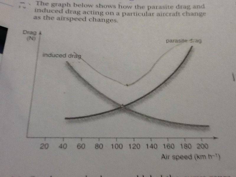

I also have another problem in regards to finding the maximum lift to drag ratio
I have been given a graph of airspeed over drag graph where airspeed is x-axis and drag is y axis
I have to find out maximum lift to drag ratio at what airspeed and when it occurs
Please help ASAP

I also have another problem in regards to finding the maximum lift to drag ratio ... I have been given a graph of airspeed over drag graph where airspeed is x-axis and drag is y axis.
There's not sufficient information. The maximium lift to drag ratio occurs where the lines cross, but there's no scale on the drag axis, and there's no information about the weight of the aircraft to compare the drag force against, even if the drag axis had a scale.
