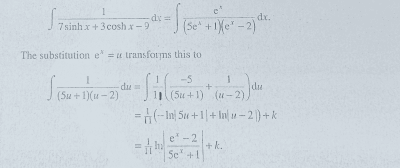

##7 \sinh x + 3 \cosh x = 9##
hyperbolic trig. equations
My question is on the highlighted part (circled in red);
Why is it wrong to pre-multiply each term by ##e^x##? to realize ,
##5e^{2x} -2-9e^x=0## as opposed to factorising by ##e^{-x} ## ?
The other steps to required solution ##x=\ln 2## is quite clear and straightforward to me.
What makes you think you cannot?
...because of this next step:
I think i get it now...to find the solution for ##x##, we can solve it as i had indicated but for the integration bit; we have to make use of all the transforms...
That solves an entirely different question than the one you asked. The one you asked about asked for the solutions of a particular equality. What that thing is is integrating 1 divided by one of the sides of the equality.
