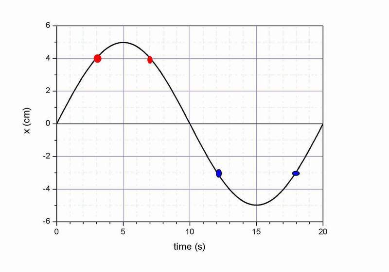

A particle executes simple harmonic motion along a straight line with mean position at x=0, period 20s and amplitude 5cm. The (shortest) time in seconds taken by the particle to got from x=4cm to x=-3cm is?
Let the equation be x=Asin(wt+Φ)
At t=0, let x=4 so that sinΦ=4/5
At t=t, putting x=-3 we get wt=sin-1(-3/5) - sin-1(4/5)
Solving for t we get t=-5s
Where is my mistake?

See attached picture. What is the shortest time to get from x=4 to x=-3?
ehild

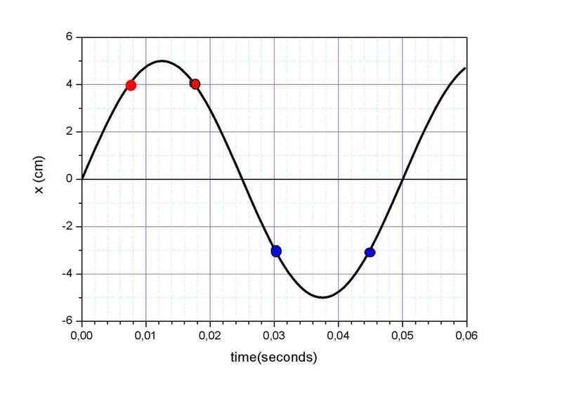

0.012s
Is this the solution of your problem?
ehild
No it is not.
The equation is x = Asin(ωt + φ)
Two equations for to positions are
4 = 5*sin(ωt1 + φ), the angle lies between π/2 and π.
-3 = 5*sin(ωt2 + φ), the angle lies between π and 3π/2.
Now can you find t1 - t2?

I misread the problem in my former post, and took the frequency equal to 20, instead of the time period. I replaced the picture with the correct one (I hope!)
ehild
