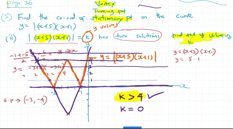

Find the set of values of ##k## for which ##|(x+5)(x+1)|=k## has two solutions
modulus
i got ##k>4## and ##k=0##
find my working...
the test book gives solution as ##k>4##. Did they miss out on the second solution ##k=0##?
k=0 and k>4 are solutions as you say.
Thanks Man...meaning the author was not keen. Cheers! Bingo :cool:
