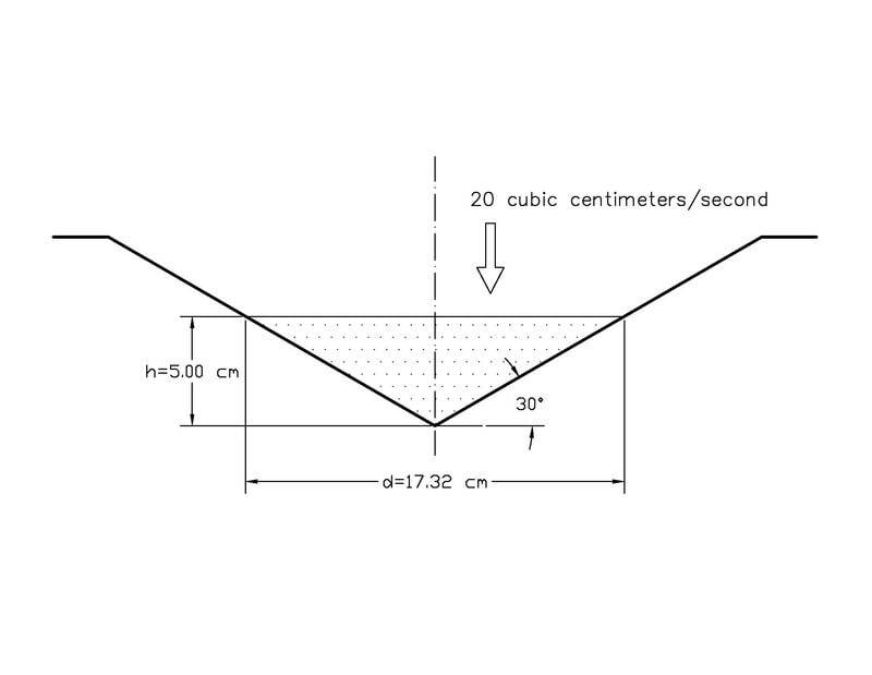

Let's go back to the question at the end of the OP.
chwala said:
Homework Statement: See attached.
Relevant Equations: Rate of change
I was able to solve it using ##\quad \dfrac{dV}{dt} = \dfrac{dV}{dh}⋅\dfrac{dh}{dt}##
With, ##\ \ r = \dfrac{h\sqrt{3}}{3}##, we shall have ##\quad \dfrac{dV}{dh} = \dfrac{πh^2}{3}##
Then, ##\dfrac{dh}{dt}= \dfrac{2×3 ×10^{-5}}{π×0.05^2}= 0.00764##m/s
My question is: Can one use the ##\dfrac{dV}{dt} = \dfrac{dV}{dr}⋅\dfrac{dr}{dt}## approach?
Well, of course it can be solved by finding ##dr/dt##, but as @Orodruin pointed out, you will then have to convert that to ##dh/dt## to complete the Exercise.
It seems that the place to start with this problem is to state that ## \displaystyle \quad V=
\dfrac{\pi r^2 h}{3}\ .##
You have ##r## and ##h## being related by ## \displaystyle \ r = \dfrac{h\sqrt{3}}{3}\ ##, which comes from ##\displaystyle \ h=r\tan 60^\circ ##.
As an aside:
You interpreted a vertical angle to be the angle that the lateral side of the cone makes w.r.t. the horizontal. I'll continue with that, but I agree with Mark that it makes more sense for it to be the angle that the lateral side of the cone makes w.r.t. the vertical axis of the cone, - also consistent with @Lnewqban's drawing.​
Substituting ## \displaystyle \ h =\sqrt{3}\, r\ ## into ## \displaystyle \ V= \dfrac{\pi r^2 h}{3}\ ## gives: ## \displaystyle \quad V= \dfrac{\pi r^3 }{\sqrt{3\,}}\ ##
so that ## \displaystyle \dfrac{dV}{dt} = \dfrac{dV}{dr}\cdot\dfrac{dr}{dt} = \pi r^2\, \sqrt{3\,}\cdot\dfrac{dr}{dt}##
The relationship ## \displaystyle \ h =\sqrt{3}\, r\ ## also gives ## \displaystyle \ \dfrac {dh} {dt} =\sqrt{3}\, \dfrac {dr} {dt}\ ##
Do a little rearranging & substituting to get your desired result.
