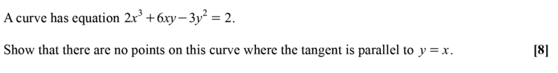

Printed exam question: A curve has equation 2x^3 + 6xy - 3y^2 = 2. Show that there are no points on this curve where the tangent is parallel to y = x. [8]
My take;
##6x^2+6y+6x\dfrac{dy}{dx}-6y\dfrac{dy}{dx}=0##
##\dfrac{dy}{dx}=\dfrac{-6x^2-6y}{6x-6y}##
##\dfrac{dy}{dx}=\dfrac{-x^2-y}{x-y}##
Now considering the line ##y=x##, for the curve to be parallel to this line then it means that their gradients are the same at the point##(1,1)##
##\dfrac{dy}{dx} (x=1)=\dfrac{-1-1}{1-1}=\dfrac{-2}{0}## does not exist...
i hope this is the correct approach unless i am missing something.

You need to show that the tangent is not parallel to ## y = x ## anywhere, not just at ## (1, 1) ## (edit: ##(1, 1)## is not even on the curve).

The above is incorrect (as already pointed out). What this should say is that ##\frac{dy}{dx}## is equal to 1, not that this derivative should be evaluated at x = 1.

Anyway this is not really relevant, the point is that as far as anyone can tell, you still have not determined what it is about the expression
that tells you that the tangent to the curve is nowhere parallel to ## y = x ##.
##\dfrac{-x^2-y}{x-y}=1##
##-x^2-y=x-y##
##-y+y=x+x^2##
##x(x+1)=0##
##x=0⇒ 3y^2=-2## but ##y^2≥0## for solution to exist, so no solution.
##x=-1⇒3y^2+6y+4=0## using discriminant, ##-12<0## hence no real roots.
