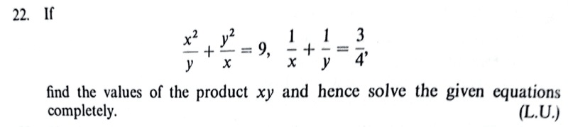

Solve the simultaneous equations
  • Thread starter Thread starter chwala
20 replies · 6K views
chwala
2,843
428
See attached
understanding of simultaneous equations
In my approach i have,
##x+y = \dfrac{3}{4}xy##
and
##(x+y)^3=x^3+y^3+3xy(x+y)##
##(0.75xy)^3=9xy+ 3xy(0.75xy)##
Let ##m=xy##
##0.421875m^3-2.25m^2-9m=0##
##m_1=8, m_2=-2.6## and ##m_3=-1.37 ×10^{-10}##
using
##m_1=8 = xy##
we shall have,
##x^3+y^3=9xy##
##x^3+y^3=72##
since,
##x+y=6##
then it follows that
##x^3+(6-x)^3-72=0##
##x^3+216-36x-72x+12x^2+6x^2-x^3-72=0##
##⇒18x^2-108x+144=0##
##x=4, ⇒y=2##
##x=2, ⇒y=4##
... other values can be found in a similar manner...There may be a better approach than mine hence my post. Cheers.

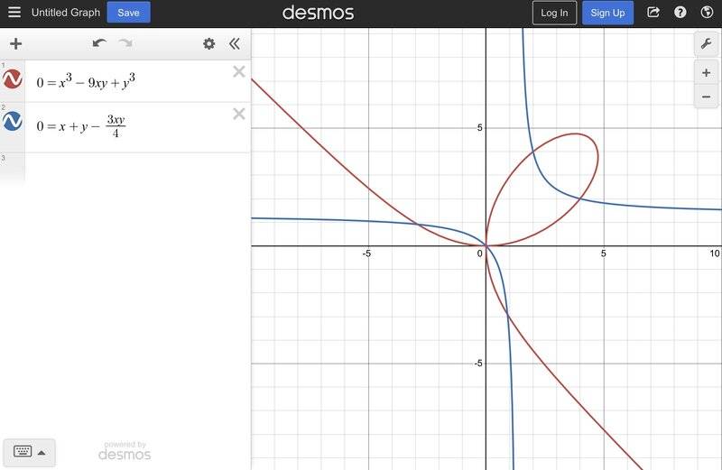

FYI, here is a graph showing the intersection of the two curves.
Reply

bob012345 said:
View attachment 356433FYI, here is a graph showing the intersection of the two curves.
It could be more useful if you could demonstrate/find alternative ways to solve the problem algebraically...the graph illustration is quite clear with me...
You can use the lines from the origin to the intercept points which have the form ##y=ax##. Substitute into each equation and get two solutions for ##x=f(a)##. Set those equal to each other and you get a polynomial in ##a##. Solving that gives four values for the slopes ##{1/2,2,1/4(sqrt(33)-7),-1/4(sqrt(33)+7)}##. Use those to get the nonzero ##x,y## values.

D H said:
The one solution that can easily be ascertained from the graph is ##y=y=0##. This is a false solution. There are four points that represent true solutions where neither ##x## nor ##y## is zero.
I think the upper right quadrant solutions are pretty clear visually from the plot.
