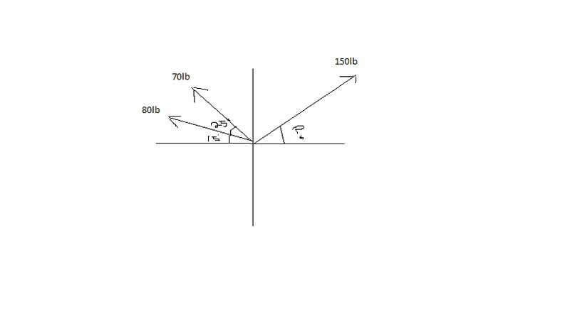

How the hell do you find this angle? see attached pic
says: determine the angle for which the resultant of the three forces is vertical.
When you read the question did you realize that the statement in read means: "there is zero horizontal component to the resultant of the three forces?"

Hello SUCRALOSE . Welcome to PF !
You really should have posted this question in a new thread, rather than "hijacking" an existing link.
was not my intention to take over this thread, I start a new one. and I still do not get it.
Can you answer my earlier question about what you saw in the wording please.
