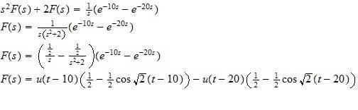

I'm asked to find the solution to the differential equation:
i'' + 2i = f(t)
i'(0)=i(0)=0
f(t) = u(t-10) - u(t-20) Unit step function (I've found in part a of the question)
Then I've gotten:
[tex]\mathscr{L}(i) = \frac{e^{-10s}-e^{-20s}}{s(s^{2}+2)}[/tex]

Do you know how to invert
[tex]\frac 1 {s(s^2+2)}[/tex]
by itself? That is what you do then use the shifting theorem with regard to the exponentials.
[tex]\frac 1 {s(s^2+2)}[/tex] ~~> [tex]\frac{1}{2} + \frac{1}{2} sin (\sqrt{2}t)[/tex]
Uhh.. I am not too sure abt the exponential shift as its sum of two exponents instead of just one of them ...

Close but not quite. Are you sure it isn't a cosine form?
Break it into two fractions with the exponentials separated into different numerators and work those.
Handwritten Laplace transform derivation: s^2F(s) + 2F(s) = (1/2)(e^(-10s) - e^(-20s)), then F(s) = (e^(-10s) - e^(-20s)) / (s(s^2+2)), partial fractions, and final line f(t) = u(t-10)(1/2 - (1/2)cos(sqrt2(t-10))) - u(t-20)(1/2 - (1/2)cos(sqrt2(t-20))).
The last equation should be f(t) instead of F(s)
