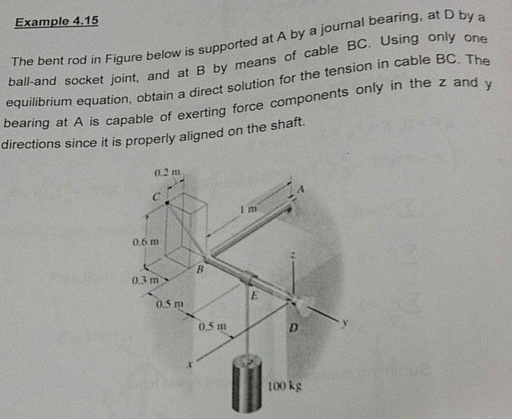

Inq this question, I am given that the u dot ( rb x tb + re x w) =0.
I knew that the rb x tb give a resultant moment pointed inside the book , which is parallel to AB... Then it cross with r AD, we will get the resultant moment.
But when re x w , I will gt the moment pointed in dx direction... How can it be related to AD?

I don't understand your question.
##\vec{r_b}\times \vec{T_B}## is the moment of the tension about D, while ##\vec {r_E}\times\vec W## is the moment of W about D.
To these we could add the moment of the forces at A about D and end up with 0, for equilibrium. However, that moment is orthogonal to ##\vec u##, so if we take the dot product with ##\vec u## that moment disappears, leaving the given equation.

I mean that the full "sum of moments about D = 0" equation looks like :
moment of the tension about D + moment of W about D + moment of the forces at A about D = 0
If we then take the dot product of that with u then the last of those three terms vanishes, leaving:
u.(moment of the tension about D + moment of W about D) = 0

Taking the dot product with u is done to eliminate the forces at A from the equation.

We have an equation. We cannot multiply some terms of the equation by something and not other terms.

Step 1: since the system is in equilibrium, total moment about D is zero:
rB x tB + rE x W + rDA x (resultant force at A) = 0.
Step 2:
We want to eliminate the unknown (resultant force at A). We can do that by taking the dot product of both sides of the equation with u:
u.(rB x tB + rE x W + rDA x (resultant force at A)) = 0
u.rB x tB + u.rE x W + u.rDA x (resultant force at A) = u.0 = 0
Now, u.rDA x (resultant force at A) = 0
(can you see why?)

yes , becoz u=rDA , they are parallel to each other

Yes, because u and rDA are parallel.

No, that cross product is not zero. The dot product of u with it is zero.
If you have a triple product a.(b x c) and a is parallel to either b or c then the triple product is zero. The reason is clear: b x c is perpendicular to b and c; if a is parallel to b then a is perpendicular to b x c.

The cross product of two vectors (if nonzero) is always perpendicular to the two vectors.
If a is parallel to b then it must be perpendicular to b x c.
