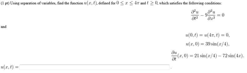

Hopefully no one will mind me posting this as an image. But here it is in tex:
Using separation of variables, find the function [itex]u(x,t)[/itex], defined for [itex]0\leq x\leq 4\pi[/itex] and [itex]t\geq 0[/itex], which satisfies the following conditions:
[itex]\frac{\partial^2 u}{\partial t^2}-9\frac{\partial^2u}{\partial x^2}=0[/itex]
and
[itex]u(0,t)=u(4\pi,t)=0,[/itex]
[itex]u(x,0)=39\sin (x/4),[/itex]
[itex]\frac{\partial u}{\partial t}(x,0)=21 \sin(x/4) - 72\sin(4 x).[/itex]
The primary assumption of separation of variables, as I understand it, is:
[itex]u(x,t) = f(x)g(t)[/itex]
I don't know of any other relevant equations, most of solving PDEs is just working through the conditions and derivatives logically and doing some careful guesswork.
I know how to do separation of variables, but I just can't figure out where the [itex]sin(4x)[/itex] comes from in the 3rd condition.
It just doesn't make any sense... Here's my math:
[itex]g''(t)f(x) = 9f''(x)g(t)[/itex]
[itex]f(x)g'(0) = 21sin(x/4) - 72sin(4x)[/itex]
[itex]f(x)g(0) = 39sin(x/4)[/itex]
[itex]f(0)g(t) = f(4pi)g(t) = 0[/itex]
and thus by using second and third of these equations:
[itex]g'(0) = (21/39 - (72sin(4x))/(39sin(x/4)))g(0)[/itex]
which doesn't make sense because g is a function of t (not x!) and [itex]sin(4x)/sin(x/4)[/itex] can't be represented in any way without x, obviously.
the method of separation of variables is defined as assuming product rule of two functions, so I can't see any other way of approaching this problem.
