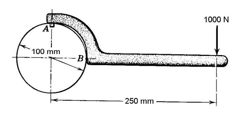

Here's a statics problem that I'm unsure about. The system is in static equilibrium, and I'm supposed to find the reaction forces.
{convention: right and up are taken as positive for x and y respectively, and counter-clockwise is positive for moment}
[tex]\sum F_{y} = 0[/tex]
[tex]B_{y} = -1000N[/tex]
[tex]\sum F_{x} = 0[/tex]
[tex]A_{x} + B_{x} = 0[/tex]
Taking the sum of moment at the centre of the circular thingy
[tex]\sum M_{z} = 0[/tex]
[tex]0 = -0.05(A_{x}) + 0.05(B_{y}) - 0.25(1000)[/tex]
[tex]A_{x} = -6000 N[/tex]
[tex]B_{x} = 6000 N[/tex]
I solved this problem assuming [tex]A_{y} = 0[/tex], by inspecting the diagram. Is that alright? In cases where it's not as obvious, how do I determine which reactions are not supposed to be considered? I think I must be neglecting something small.
Thanks in advance.
You can't just randomly consider a reaction force to be 0. I'm not sure how you inspected the diagram to come to that conclusion.
It comes down to you having 4 unknown reaction forces ([tex]A_x,A_y,B_x,B_y[/tex]) and only 3 equations of equilibrium ([tex]\sum F_{y} = 0[/tex], [tex]\sum F_{x} = 0[/tex],[tex]\sum M = 0[/tex]) Like you said, you have to find some other equation based on other information.
By looking closer at the diagram it appears as if point B is not physically attached to the circle. That would suggest that it is free to move vertically so [tex]B_y=0[/tex]. It's hard to say from that diagram though.
Does anyone have a second opinion?
(By the way, welcome to PF and thanks for showing your work and making it very clear)
Edit: Also, when you summed the forces in the y direction I think you missed a negative sign.
I solved this problem assuming Ay = 0, by inspecting the diagram.
I don't think you can assume that, infact I think the opposite, for the system to remain static Ay must be non zero. Perhaps I am wrong, could you post your thought processes.
I would agree with you there dav. We can say that By = 0 if we assume that the system is frictionless, which seems like a reasnable assumtion as we are not given any coefficents. I am also assuming ofcourse that the spanner is light.
So now you have three unknowns and three equations. Happy Days :smile: I also would like to comend you on your post, all the required information was provided and it is presented in a clear logical fashion, a pleasure to read.
Definetly agree with the replies, but i will also want to request the problem statement, maybe there's more info there?
