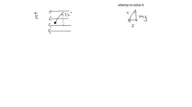

a 030 kg ball is suspended in a uniform electric field as shown. If the charge on the ball is 500 x10^-4 C, what is the electric field strength?
E= F/Q
I did this by using the triangle method. draw the forces with a triangle(look at the attachment).
My question is did i draw the triangle right? Does the direction of the Electric field affect my answer?
  • Hand-drawn diagram of a ball hanging at an angle of 12 degrees from vertical in a horizontal electric field pointing left, with a dashed vertical reference line; to the right, a force triangle labelled T, mg and F.
Since the ball is in equilibrium, the forces on it must add to zero.
Look at the direction of the tension force in your triangle.
oh my, thank you so much ap123!
I just got the tension force backwards, now it makes much more sense! thank you !
