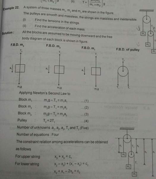

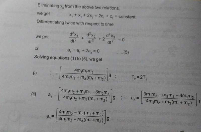

I am thinking of finding a3 through another way in this solved question
Solution page for Example 22 showing a pulley system with three masses m1, m2, m3, free-body diagrams of each block and of the pulley, and Newton's second law equations (1) to (4) with the constraint relations for accelerations.
Printed solution text with equations: constraint x1 + x2 + 2x3 = 2c1 + c2 differentiated twice to a1 + a2 + 2a3 = 0, then tensions T1 and T2 = 2T1 and accelerations a1, a2, a3 in terms of m1, m2, m3 and g.

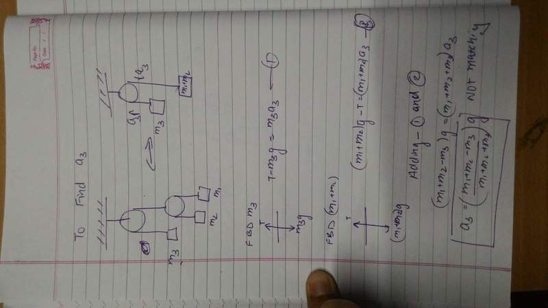

I am thinking of considering m2 and m1 as one mass but answer in not matching. I couldn't find what I am doing wrong.
Handwritten notebook solution, rotated sideways: a pulley diagram with masses m1, m2 and m3 labelled with accelerations a3 and a1, free-body diagrams for m3 and for m1+m2, equations T - m3g = m3a3 and (m1+m2)g - T = (m1+m2)a3, and a boxed result a3 = (m1+m2-m3)g/(m1+m2+m3), marked NOT matching.
Thanx in advance .
The problem with treating m1 and m2 as a single system is that the acceleration you'll find (using Newton's 2nd law) will be the acceleration of their center of mass. That acceleration is not the same as the acceleration of the pulley.
If m1 and m2 were fixed together, instead of in relative motion, then you'd be fine. (Obviously, that is not the case here.)
