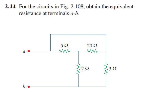

No idea how to do that . Was thinking maybe making the 3 and 2 ohms resistors equivalent (assuming parallel). I have no idea what to do with the top wire . How do I simplify this circuit?
The 2 and 3 Ohm resistors are not in parallel (their upper ends are not connected).
Hint: Re-draw the circuit with the 5 and 20 Ohm resistors in a vertical position.
RiceKernel said:
Req =R1 + R2
Req = (R1*R2)/(R1 +R2)

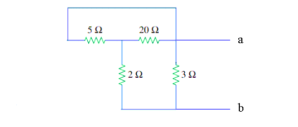

You're allowed to re-arrange the components on the page so long as all the connections remain the same. Take a close look at how the 5 and 20 Ohm resistors are connected. Better yet, move terminals a and b to the other end of the circuit. You can do this because a continuous wire path is all the same node, and anything connected to it can be moved to another point on the same conductor.
