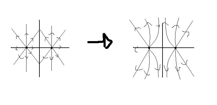

Could you mildly explain how to sketch these flow lines, I have 3 examples only on this, each one he found the components ur and uθ at z0 = 0
If I do this I get (saving the working out)
at z0 = 0
ur = ∂φ/∂r = 0
uθ = (1/r)∂φ/∂θ = -k/r
Then (for the example similar to this question) all he did was draw a point vortex with circular flow lines about z0 = 0 going anticlockwise
So I draw the same thing but at z0 = -a and z0 = a, and... then I don't know what to do from here!

Oh I see, so we know the fluid is irrotational, so z0 = a and z0 = -a are either a soure or a sink, how do I identify which?
I'm assuming theyre sources since the question wants me to show it's a strength 2k
my attempt:
So because they superimpose on each other, that's 2 times the strength?
Exactly, but only at large distances, where it 'appears' as one source with a strength of 2k.
At distances that are large relative to the separation of the sources, you essentially get equally spaced radial lines pointing out from the center.
At small distances the variation in the flow lines is sufficient to deduce that there are actually two sources.
Source or sink for a positive or negative sign is a matter of convention. I believe that the standard convention is to treat positive signs as sources, as well as clockwise flow if rotational.
