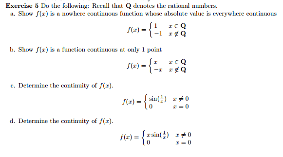

The problem is posted below in the picture. I looked at c and d and can do those. I am unsure about a and b.
I looked at graphing the problems, but I think it is a wrong approach.
Graphing a) and b) might be helpful. What is the definition of continuity at a point?

You said you were unsure about parts a and b. What are your thoughts about these problems so far?
For "a" I was thinking it can't be continuous because the graph would be broken up and you technically could not draw the graph without picking up your pencil.
For "b" I was thinking 0, but I think it is wrong.
For a) why is |f| continuous? For b) you say, "I was thinking 0." Can you elaborate on this? Try to be as clear as can about what you mean.

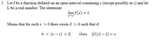

Attached is the definition about limits.
I think "a" is not continuous because the graph will be alternating between 1 and -1 and not stay at a straight line. I would have to pick up my pencil to draw the graph.
For "b" I was thinking 0, because the limit as s approaches 0, the graph approaches 0.

All of the functions listed in parts a through d are defined for all real numbers, so that's not the issue. What are they asking you in this problem?

They are asking me to show f(x) is nowhere continuous. Well it is nowhere continuous because it is not continuous at each point in the interval. I think I got a now. would this work?

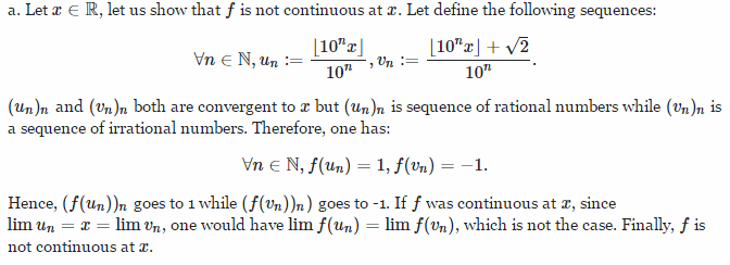

KF33 said:
Is this an idea of what you are getting at.
More like the example you posted as an image, the one with the two sequences.
