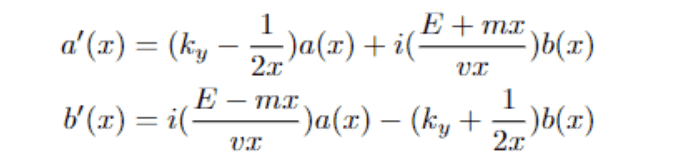

Hey all,
I am currently struggling decoupling (or just solving) a system of coupled ODEs.
The general form I wish to solve is:
a'(x)=f(x)a(x)+i*g(x)b(x)
b'(x)=i*h(x)a(x)+j(x)a(x)
where the ' indicates a derivative with respect to x, i is just the imaginary i, and f(x), g(x), h(x), and j(x) are arbitrary functions of x.
Is there a closed form solution for this kind of problem?
Any help would be appreciated.
Thanks.

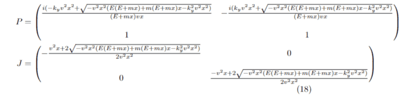

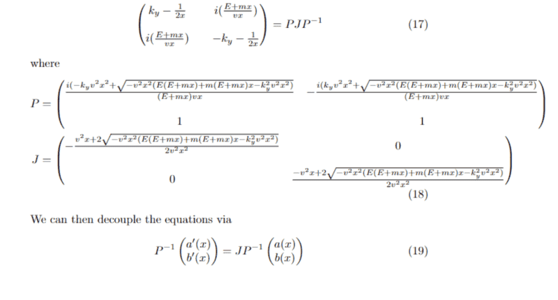

I am not sure if this is the same or not, but the full equations look like:
where k_{y}, E, m, and v are all constants. Nevertheless, I got as far as (19) after which I am stuck because I was unable to bring the derivatives for a'(x) and b'(x) outside. Is this method still valid ultimately then?
If you have ##(19)## then you are done. Multiply ##(19)## by ##\det P## and write ##\det P \cdot P^{-1}=\begin{bmatrix}

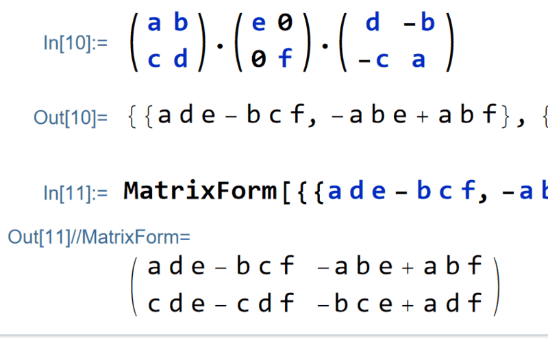

But just referring to any (suppose diagonalizable) 2x2 matrix, I get the following:
Are you claiming that this matrix is diagonal?
A matrix ##A## is diagonalizable if there is a regular matrix ##P## such that ##P^{-1}AP=D## is a diagonal matrix ##D##. This is more or less the same as saying the equations can be decoupled. The art is to find ##P##, and since we have functions as coefficients, we must do so without divisions. But this can be done if we carry the determinant all the way because this is the only term that needs to be divided.

Yes, indeed that is the case, so (17) is the equation that I performed the Jordan decomposition on, i.e J is diagonal and P is the matrix that satisfies (17). With that being said, doing det(P)*P*J*P^{-1} should not be diagonal in my mind because it is simply multiplying the LHS of (17) by a constant factor right?
(18) gives the explicit form of the decomposition if that helps.
The determinant is ##\det P=2is## where ##s## is the root expression (and denominator). Since ##v,x\neq 0## anyway, we will have no problems with the determinant. This means you can proceed with the literature that normally deals with numbers as coefficients.

\begin{align*}
J(x)&=\begin{bmatrix}
\mu(x) & 0 \\0 & \lambda(x)
\end{bmatrix}\, , \,P:=\begin{bmatrix}
\alpha(x) &\beta(x) \\1&1
\end{bmatrix}\, , \,\det P(x)=2\cdot i \cdot s(x)=\alpha(x)-\beta (x)\\
\end{align*}
