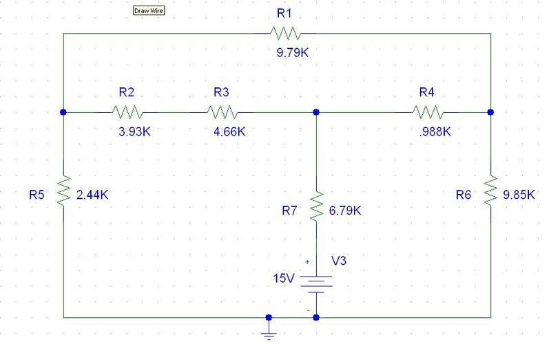

The discussion focuses on solving for currents in a circuit using the principle of superposition. Participants explore various methods and approaches to tackle the problem, including node equations and mesh currents.
- Homework-related, Exploratory, Technical explanation
- One participant expresses uncertainty about the next steps after isolating each source, questioning whether node equations are the best approach.
- Another participant suggests that the principle of superposition requires multiple sources and questions the absence of a second source in the circuit.
- A later reply confirms the presence of an additional 9V source in series with a resistor, indicating a correction to the initial understanding of the circuit.
- One participant proposes that using mesh currents might be a more efficient method for solving the current, and suggests combining certain resistors to simplify the calculations.
Participants do not reach a consensus on the best method to solve the problem, with multiple approaches being discussed and uncertainty expressed regarding the application of superposition.
Some limitations include the initial misunderstanding of the circuit configuration and the potential need for further clarification on the application of superposition in this context.
