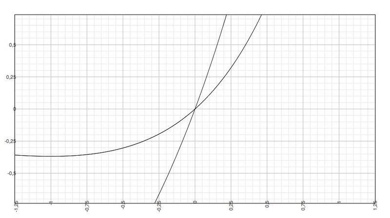

3(e^{x}-1)-xe^{x}=0 I do not believe you can solve this one algebraically, one can only approximate the solution to these kind of equations.
i think a graphical method is usefull...
ciao

By inspection we can see x=0 is a solution. Do you have any reasoning to believe there are other solutions?
Edit = maybe I was to hasty - there seems that there is at least one more solution.

and there is another solution if you graph the equation you can find it approximately
its about 2.something
